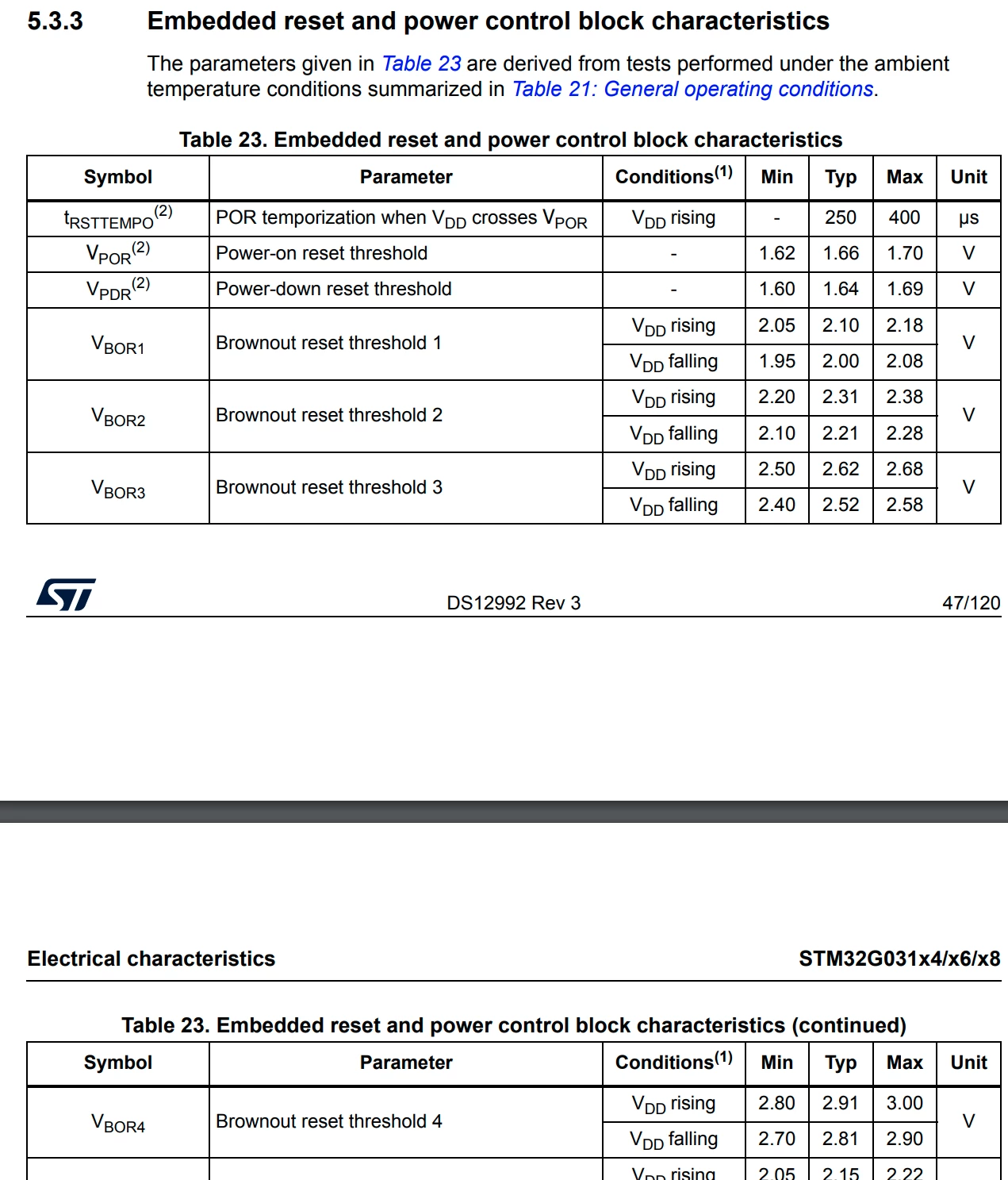

Hello!
When I connect to STM32G030 with the ST-Link programmer in the Options bytes tab, I can adjust the BOR levels (level 1-4 F and R). These levels are not described in the datasheet (DS12991 Rev 3). What are these levels and where can I find their descriptions?
1 reply
December 12, 2021
The STM32G0x0 doesn't have a BOR per the reference manual or the datasheet.
The STM32G0x1 does, and you can find the levels in the datasheet.
If the BOR option bytes are available in STM32CubeProgrammer for the G0x0, they may or may not work the same as the G0x1. They may be available but simply not tested.
