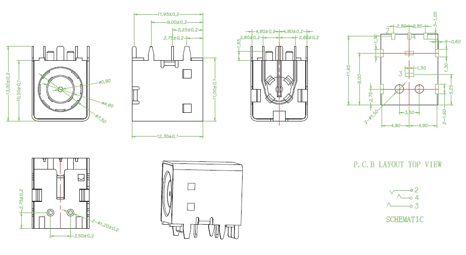

What are the barrel jack sizes for the STM32G081B-EVAL board?
Evaluating the STM32G081B-EVAL board, and I’m struggling to find the sizes of the two DC barrel jacks on the board and UCPD daughter board (5V CN16 and 19V CN3). As I understand it, it would be sufficient to power CN3 and let that power the mainboard, but I can’t find either of these sizes.
Checking the BOM shows CN3 as Qiaod DC-094, but I can’t find any information about this either.
Does anyone know what size of power supply barrel jack we will need for either (preferably CN3)?

Main board MB1350 can be powered by UCPD daughter board MB1352 when JP17 on MB1350 is set to “D5V”.
Parameters of CN3 on MB1352 are shown in below:

If you Google “DC-094 jacks”, it comes back with the barrel being 3.2mm x 1mm.
There could be some variations where the OD could be 5.5mm.
So, not to assume what the size could be, I would just use a caliper to make measurements.
