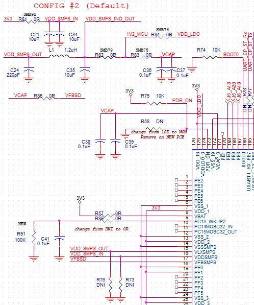

we are using STM32H755IIT6 MCU we made 5 boards with the same MCU STM32H755IIT6 all the board can be programable with verification but only one board of start to run what we can check on the board to find the problem

Tesla DeLorean
Guru
February 20, 2022
Voltages and capacitors of VCAP pins.
BOOT0 pin pulled-low.
Level of NRST pin
Settings for LDO/SMPS and VOS in SystemClockConfig()
Flash settings
External clock vis HSE_VALUE define,
Stuck in Error_Handler() or HardFault_Handler()
One could perhaps use a debugger and see where things are stuck, use LED, GPIO or UART to indicate progress into code.

  • Voltages and capacitors of VCAP pins. - yes
  • BOOT0 pin pulled-low. - via 10K resistor
  • Level of NRST pin - 3.3V
  • Settings for LDO/SMPS and VOS in SystemClockConfig() - what do you mean
  • Flash settings - 2 ws
  • External clock vis HSE_VALUE define, - we are using internal clock
  • Stuck in Error_Handler() or HardFault_Handler() It is not start at all
  • One could perhaps use a debugger and see where things are stuck, use LED, GPIO or UART to indicate progress into code. - we cant use the debugger it is look that we dot have clock

Tesla DeLorean
Guru
February 20, 2022
You said you could program/verify, processor is working. You should be able to step through Reset_Handler, ie don't "Run to main()"
VCAP should be around 1.25V
The power supply settings should be consistent with the design. You've shared nothing of the code or design. If you're using the internal LDO, make sure that's selected.
Two wait states at what speed? Should be at least 4 for 400 MHz

we are running internal clock 64Mhz.
2 wait state
voltage scale 2
the code :

0693W00000KZqBpQAL.pngwe are using the SMPS as the schema

Shouldn't VCAP capacitors be 2.2uF each, not 100nF?
Double check PDR_ON expectations​.

we try to all the option
we did add capacitors on the VCAP
we did try to use external VCAP (1.2V or 1.1V) and the same
