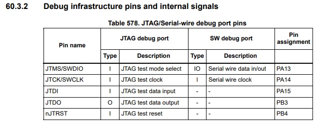

H3llo @dv.13​ ,
This could be a misconfigured option byte issue. See if PCROP is checked and uncheck it if is the case (see STM32CubeProgrammer User manual section 2.4). A hardware failure is also possible (Issue with some JTAG pins) a would be the most probable if the MCU is really blank. Down below are the JTAG pins for STM32H750x (strait from the reference manual):

 PCROP is unchecked. I tried to toggle it, but it gives error "Option bit programming failed". even Mass Erase is also not working.
the same IC got programmed on other PCB. So this might be some hardware issue.
I checked for above pins if they are short to some other pin or gnd or 3.3V or open but no luck.
any other pin to be checked?
