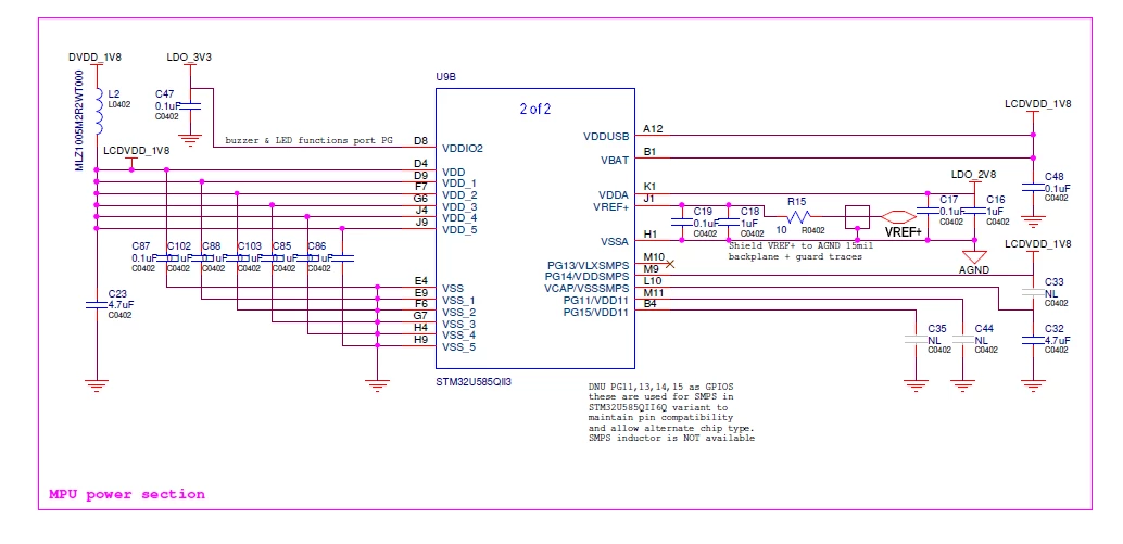

Dear Sir.
Attached a schematic of STM32U585 .
LDO_V28 is tested for 2.8v.
Issuing the command
HAL_SYSCFG_VREFBUF_HighImpedanceConfig(SYSCFG_VREFBUF_HIGH_IMPEDANCE_DISABLE);
HAL_SYSCFG_VREFBUF_VoltageScalingConfig(SYSCFG_VREFBUF_VOLTAGE_SCALE2);
  HAL_SYSCFG_EnableVREFBUF();
No output at VREF+ .
Later the ADC_CALIBRATION gives an error.
Please Advise.

waclawek.jan
October 6, 2022
Read out and check/post VREFBUF_CSR register content.

Hello @Community member​,
Try this sequence :
  1. __HAL_RCC_VREF_CLK_ENABLE();
  2. HAL_SYSCFG_VREFBUF_HighImpedanceConfig(SYSCFG_VREFBUF_HIGH_IMPEDANCE_DISABLE);
  3. HAL_SYSCFG_VREFBUF_VoltageScalingConfig(SYSCFG_VREFBUF_VOLTAGE_SCALE0);
  4. HAL_SYSCFG_EnableVREFBUF();
