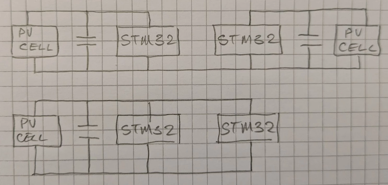

Hello, I am attempting in voltage stacking of 2 STM32WB55 board, but unlike arduino I could not connect Top board's GND to bottom board's 3.3 V pin. I would like to request for help or insights for alternative method I could make it work. I would really appreciate the help.
Problem
1. When I connect the Top STM32 GND to the VDD of Btm STM32, it discharged the voltage in Btm capacitor.
2. On one attempt I rearranged the circuit in similar stacked configuration, it did not discharged the Btm capacitor voltage. Instead the system goes haywire.
Thank you.
