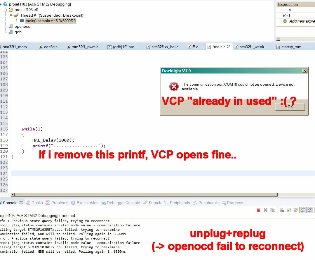

samuel23
July 1, 2020
I have the same issue.... I think it is related with some recent changes in st-link firmware.
Indeed, I use the Nucleo F103 with VCP in many contexts since years (and "student-proof" contexts!... which is.... instructive ^^).
Recently, the VCP is sometimes impossible to open...
Some serial-terminal-software indicates the port is still in use.
I investigated and found this:
  • While debuging session is active, if my software does not send anything to the UART, I can open the VCP (always..)
  • While debuging session is active, If my software send some datas to the UART before opening the VCP, it is sometimes impossible to open the VCP next (until reset the ST-Link MCU)!
  • If i do not kill the debugging session, unplug+replug USB -> I cannot open VCP.
  • If i kill debugging session, unplug+replug USB -> that is OK!
So the problem seems appear when datas are send to the "ST-link-f103" during openocd is running on the host.
My context: OpenWorkbenchForSTM32 (using OpenOCD+GDB) + external serial terminal.
I guess this problem is appears recently in the ST-Link firmware.
Sorry... my "answer" is not relly an answer... but it could help to focus (/correct?) this f**ing problem!
