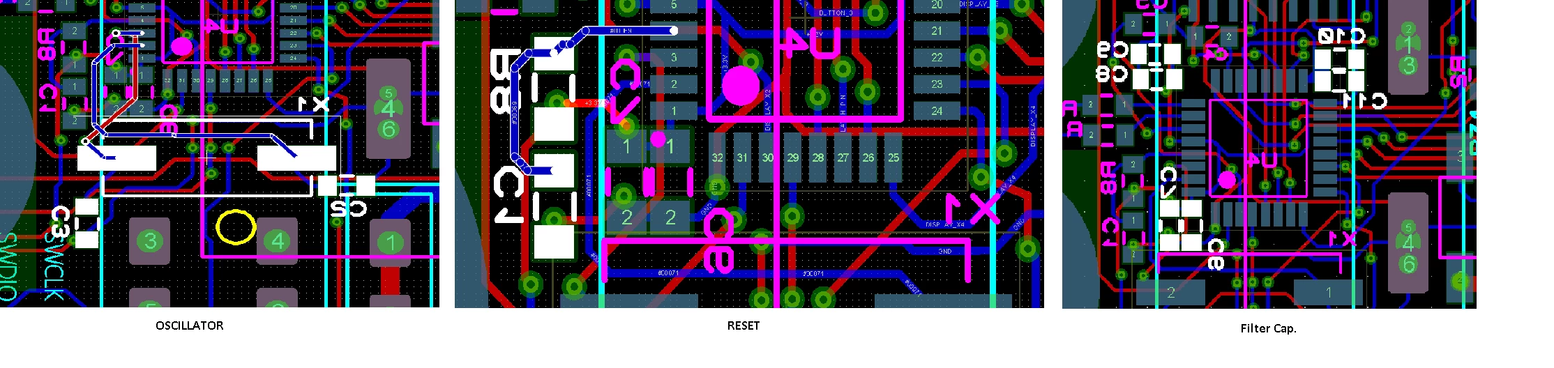

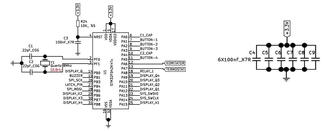

I design oven timer (transformerless) with STM32F042K4T6. Although I tested everything separately there is a problem in the pcb. When the system first comes on, the system works but sometimes it doesn't. I tested it 10 times and the MCU didn't work twice...
Has anyone ever experienced anything like this before? Your advice is very important to me.
Schematic;

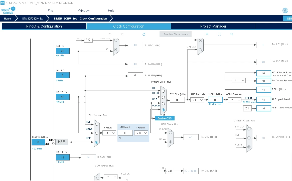

Clock Config;
Filter Capacitor, Crystal (8Mhz) and NRTS resistance locations;

Put a pull-down resistor on PB8 (31)

Would a pull down resistor of 4K7 preclude your usage elsewhere?
If you don't understand the relevance of the pin you might want to urgently review the documentation.

I would recommend to remove R24 and what means the system is not starting? If for exemple you put a simple LED toggelling and while (1) to know at which step it is hanging.. it may be a software configuration not in spec. How many units are affected?

I suspect "not starting" infers it is in the ROM as opposed to user code, or stuck in a while(1) loop in Error_Handler() if the crystal fails to start promptly.

Agreed on BOOT0 and R24.
Also I don't see the capacitors recommended in AN4080. And most likely an oven doesn't need quartz crystal at all - HSI is good enough.

I didn't want to take risks. I'll test HSI, thank you. :)
