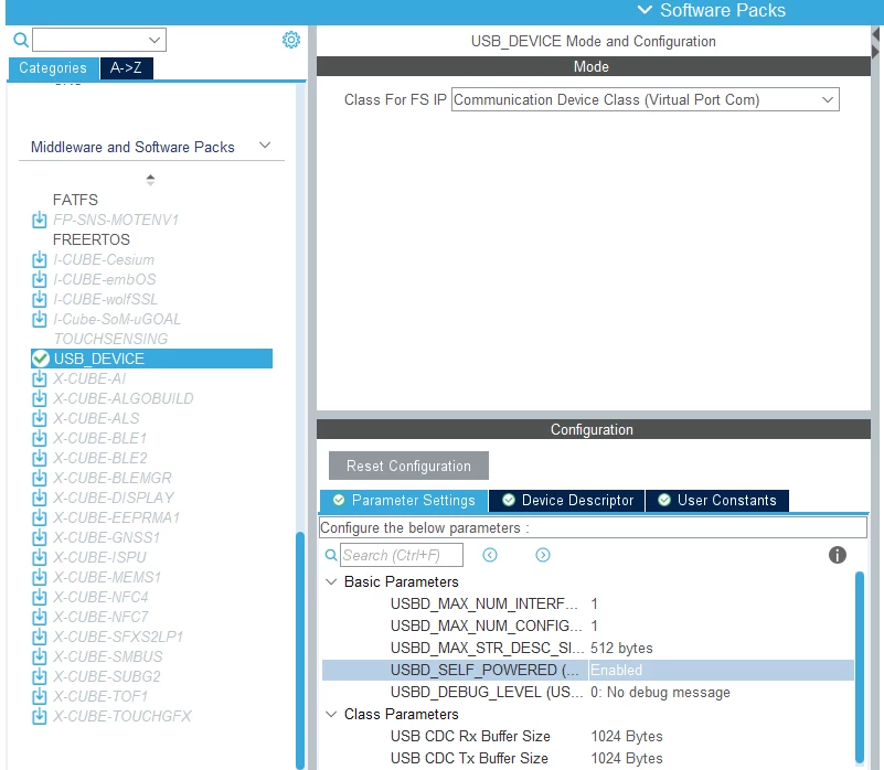

It's my first question i'm new to STM32.
I use Win 11 and a Nucleo F303ZE (and a Nucleo F303RE, same problem), and y i need to use the virtual com port on the STM32 F303.

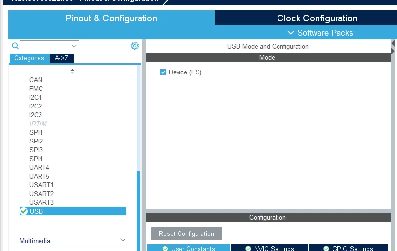

So, I try to enable the Virtual com port on the Nucleo F303ZE on th 2nd USB port (CN13) which is connect to PA11 and PA12.
the USB_DEVICE config on STM32Cube IDE:
The USB setting:
Normally, it's ok. But, if i plug a (tested) USB cable on CN13 (which is plug to PA11 & PA12), or not, nothing happend on window. I see a Virtual Port COm, but it's the ST LINK. I do something wrong?
I see the video :https://www.youtube.com/watch?v=h9T0RTu9Muc&list=PLnMKNibPkDnFFRBVD206EfnnHhQZI4Hxa&index=11
But it doesn't help me.
Thanks in advance,
Guillaume

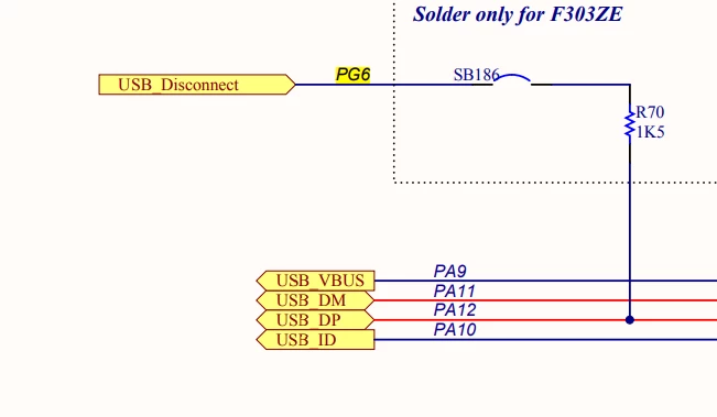

Best answer by le-gal.guillaume
I found:
Set PG6 (USB_PowerSwitchON) to High (Low by default) and it works:
This part of the scematic gived me the clue:
BR

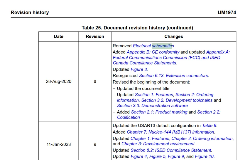

RhSilicon
Lead
August 3, 2023
I tried to see the schematic of the board to try to understand how it works, but unfortunately the ST is going against the grain.
August 4, 2023
here is the schema:
BR

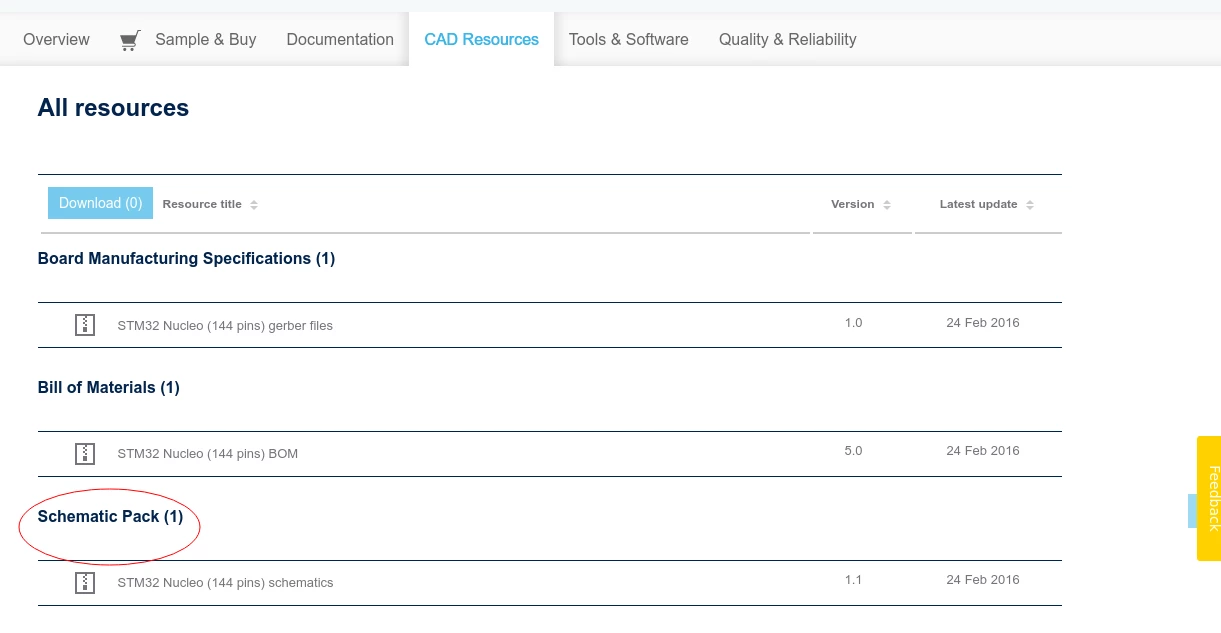

RhSilicon
Lead
August 4, 2023
@le-gal.guillaume wrote:
here is the schema:
BR
Thanks, I opened a question about the schematic, now the schematics are available in the CAD Resources tab.

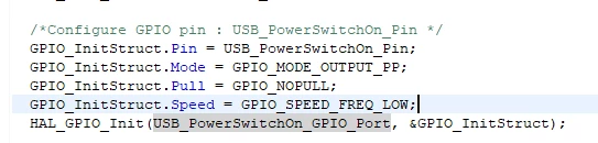

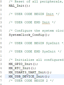

By the way, is it normal that USB_DP is at 0 after MX_GPIO_Init()?
The piece of code in MX_GPIO_Init() where  USB_DP switch to 0:
BR

I found:
BR
