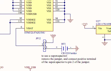

Most of STM32 MCUs have Vbat pin on which you can connect a battery or supercapacitor.
This is an example from STM32L476-EVAL board:
If JP12 position is 2-3. Vbat pin is connected to the battery.

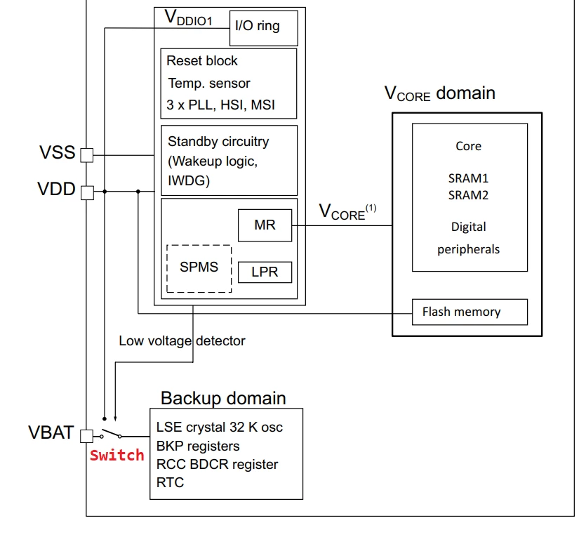

Internally, there is an internal power switch that controls which power supply will feed the backup domain (that includes RTC) and there is a power low level detection mechanism that monitors VDD. If VDD is available, backup domain is powered from VDD, but if the latter is lost, the switch status changes and will let backup domain to be powered from Vbat (battery).
PS: you can connect CR2032 to Vbat pin.

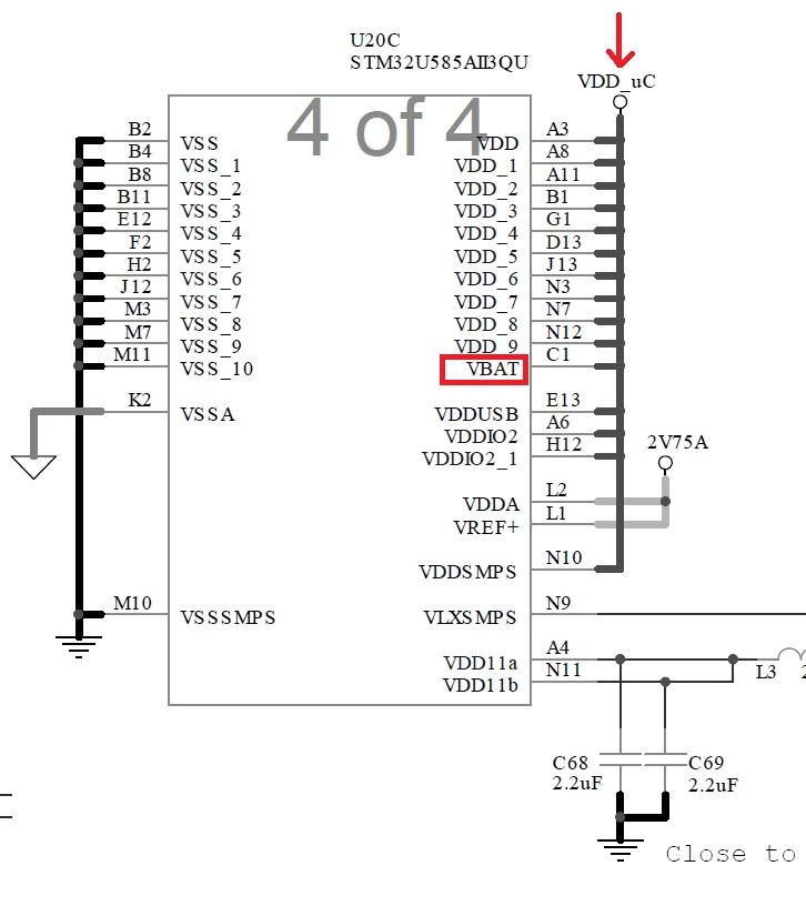

mƎALLEm
February 27, 2024
You said you're using STWINBX1 board.
After checking its schematics, and unfortunately for you, VBAT is tied to VDD in the PCB:
So if the VDD is lost you lose the time and date.
You said your board have a battery.. It could be to power all the board not Vbat pin. So you need in that case to guarantee that the battery keep feeding the system to prevent losing time and date.
Above I'm talking about a battery that could be connected to Vbat pin.
Hope I answered all of your questions.
