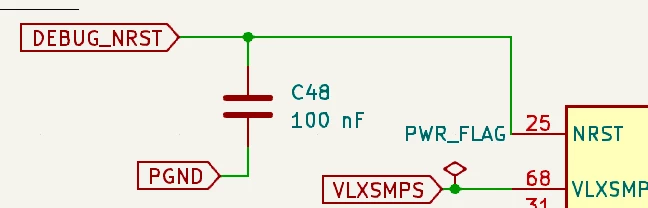

Apr 13, 2026 12:40 PM UTC
It can't, although I connected my MINIE V3 to a nucleo board so that's not the problem.
I followed this schematic (https://www.st.com/resource/en/schematic_pack/mb1549-u575ziq-c03_schematic.pdf) but the 100 nF capacitor on NRST doesn't seem to go to zero when I connect the debugger. It gets to about 1.8V. One thing I didn't do is add the ESD protection.

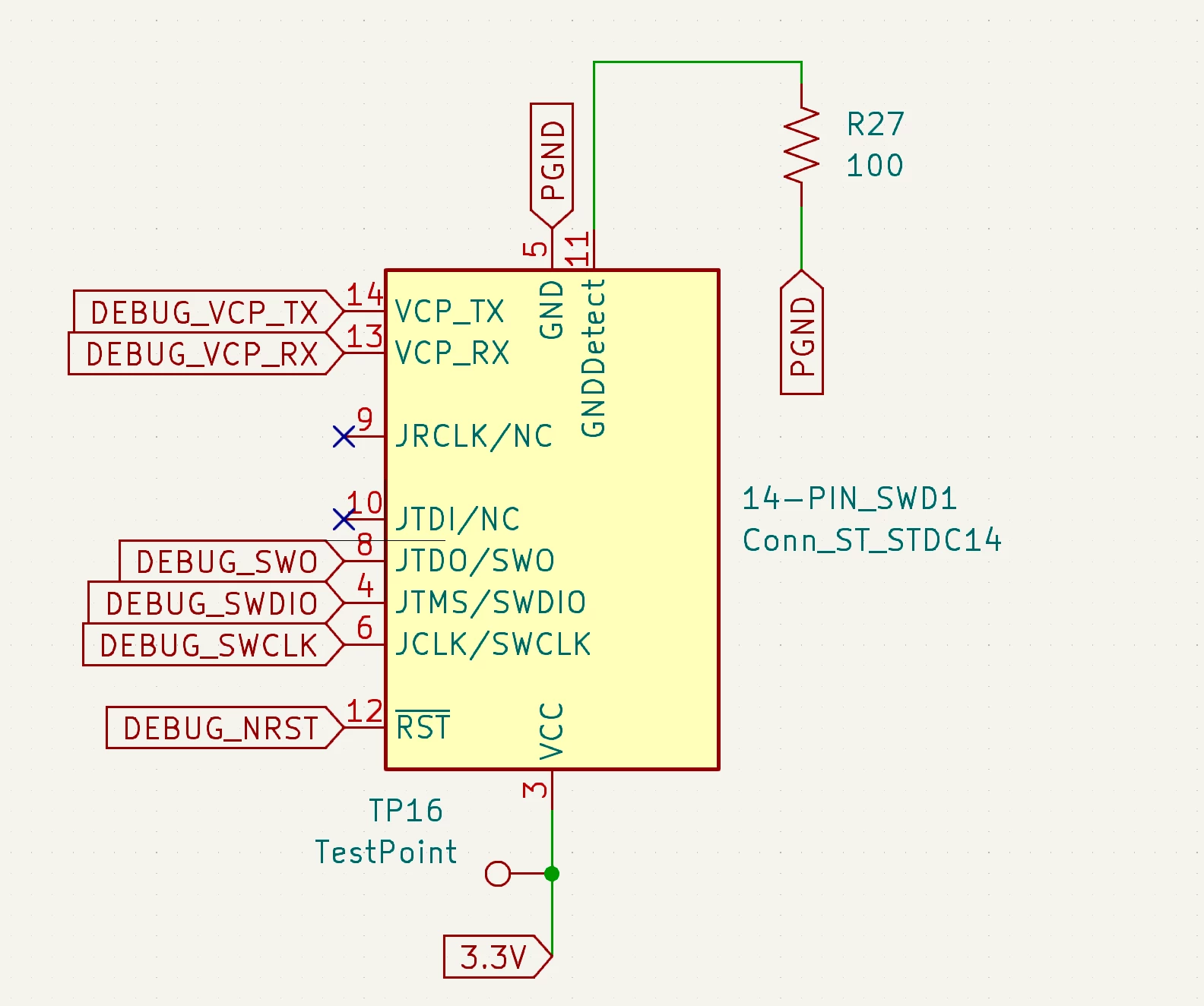

Apr 13, 2026 2:08 PM UTC
I copied the nucleo schematic I linked earlier.
As I mentioned the MINIE is fine as I connected to nucleo board and visualised it on CubeProgrammer.
I cannot complete the table as I'm unable to connect the parts in the manners suggested.

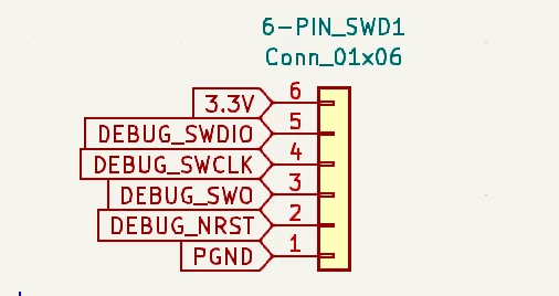

Apr 13, 2026 2:12 PM UTC
And here's the 6-pin connector.
Apr 13, 2026 4:04 PM UTC
Schematic is okay. Maybe the footprint on the connector is wrong, or it's installed in reverse.

WellLeithedAuthorBest answer
Apr 13, 2026 7:47 PM UTC
I've just noticed that the footprint of the connector has pins 5 and 6 mixed up. Anyone have any ideas for removing the trace connecting pins 6 and 7 under the 14-pin connector (hahaha!)? Thank God for the 6-pin fallback the board has. And thank you for your willingness to help.

Andrew Neil
Apr 14, 2026 8:11 AM UTC
Use an adaptor cable / interposer to correct it.
