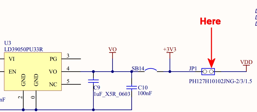

I understand your points. What I gather from what you're saying is that even when JP1 is open, it will not affect other peripherals. However, I believe it does affect them.
In  UM1956 Rev 5, section 6.7, Hardware layout and configuration, it is mentioned that:
JP1 on: STM32 is powered (default)
JP1 off: an ammeter must be connected to measure the STM32 current
If there is no ammeter, STM32 is not powered.
So I think this is because VDD is out . And I think the VDD is the main supply voltage that powers the core and peripherals.
I also connected a logic analyzer to check their signals, and I found that their signals (UART, SPI, and I2C) are available only if JP1 is connected.

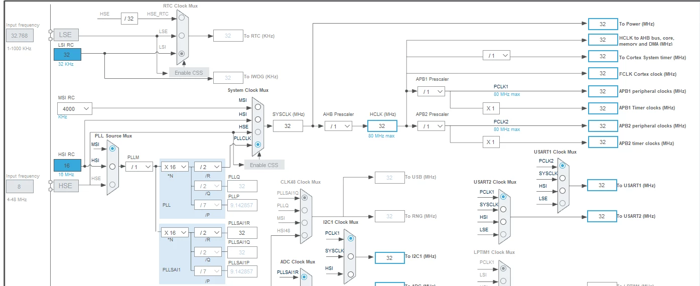

Clock Configuration (I used MSI):

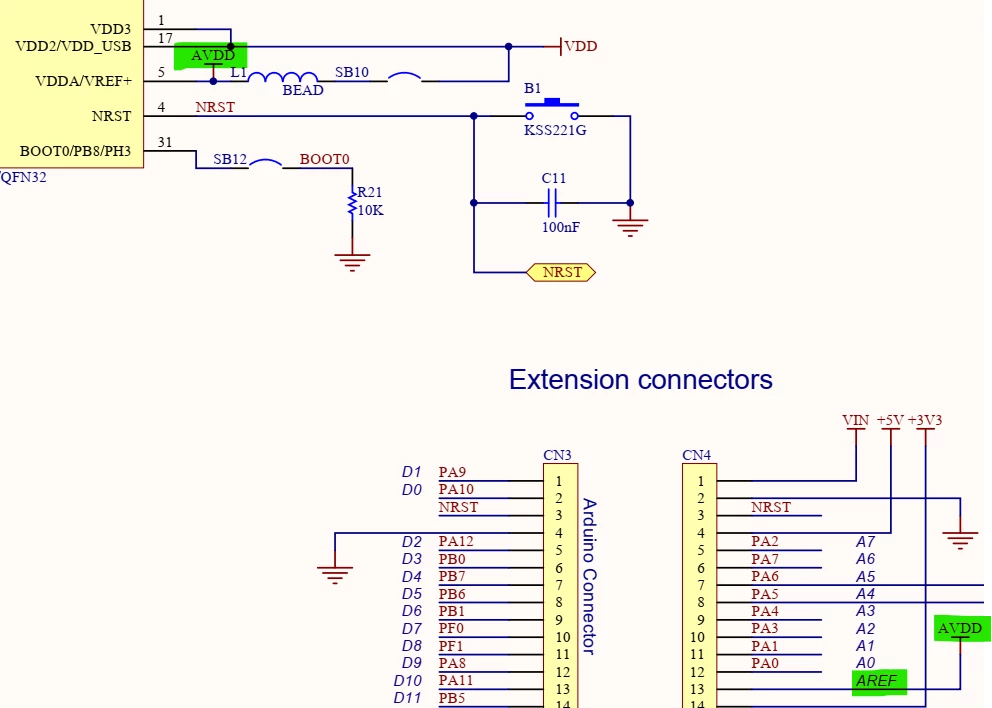

April 16, 2024
Yes, your diagram is correct.
  • LoRa, Sensor, and Optical TX are connected to +3v3 and +5V pins
  • STM32 also is supplied from X-Nucleo-LPM01A using AREF pin
All three power sources are available for the system (I have checked the pins using a multimeter).
however, I am not sure if the AREF pin is internally connected to smt32 or not. Based on the diagram it is connected and there is no bridge and it is connected to AVDD directly.

Andrew Neil
April 16, 2024
Why not apply it at the VDD side of JP1 ?
Note that you'd also need to link the X-Nucleo GND to the L432KC GND
Yes, it is connected via SB10 and the L1 ferrite bead - which is there to filter digital noise from the analogue supply.
You are effectively feeding the power from the "wrong" side of the filter.
Jay_Bolboli
April 17, 2024
Hello @Andrew Neil @RomainR.
I want to thank you both for your help and support.
It appeared that the problem was the AREF. It was provided by the X-Nucleo-LPM01A, and I was able to measure it on the pin.
However, I discovered that internally, the AREF wasn't connected to MCU. I suspect this might be due to the ADC. In my application, I'm using the ADC, so it's likely that the AREF was being utilized as the reference voltage for the ADC. When I tested it without the ADC, the problem was solved.
