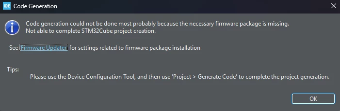

issoAuthor
Aug 7, 2025 5:27 PM UTC
So I unchecked Virtual COM Port in the ioc config and USART3 seems to be available now. But I often get this window msg from time to time. I'm sure I keep checking for updates but still get it oftentimes.
Andrew Neil
Aug 7, 2025 7:00 PM UTC
So did you see the Firmware Updater - as it says?
issoAuthor
Aug 7, 2025 7:49 PM UTC
Sure thing! but it keeps coming back from time to time..
Now works fine though!
