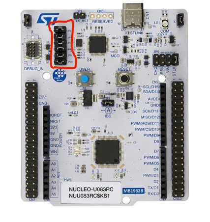

I need an ST-Link to debug external STM32U0 devices, specifically to modify option bytes and use RDP regression with OEM keys via STM32CubeProgrammer, and I was wondering if the JP6-11 pins on the Nucleo-U083RC could be connected to another MCU to use it as an ST-Link.
Thanks in advance

this is not possible.
The internal ST-Link of your board can only be used for the board MCU (or disconnected to use another debugger).
Only the ST-Link v2 found on older NUCLEO boards (with breakable PCB) can be used for other MCUs.
You will have to get an external ST-Link - which is affordable, but take care not to get one of many clones.
