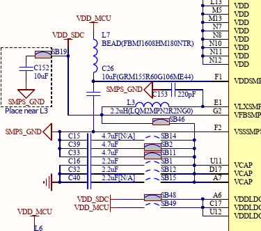

>Or is it trying to show that the SMPS can supply power externally?
Maybe - but who wants this ? :)  (+ I would not make games with this, just get the cpu running. )
>Does that all sound correct?
yes...
You have to separate the vcap from smps !  -> remove sb46 !! add c152 + sb19 (if not there)- check.
But double check: not to supply/connect core (VCAP pins) with SMPS any more ! You kill the cpu then.
check this and the connections you made with DMM for good contact - before apply any power !
Otherwise - not so difficult action - right ?

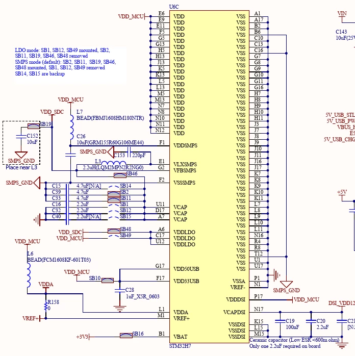

Hello @TonyFocusLCDs ,
Indeed for a system clock of 480MHz with VOS0 you need to use LDO not the SMPS. The disco board you are referring to is hardwired in SMPS and you cannot use other power mode. So you cannot exceed 400MHz at VOS1 on this board.
Hope I answered your question.

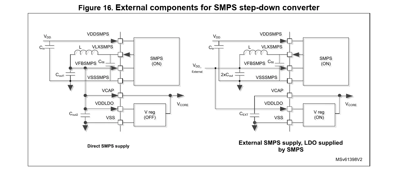

>If you can only use the PWR_LDO_SUPPLY, then PWR_SMPS_1V8_SUPPLIES_LDO (and 2V5) are completely useless settings, why even bother having them? We would either use only the SMPS (for power savings) or the LDO. Then PWR_SMPS_1V8_SUPPLIES_LDO (and 2V5) become meaningless settings.
No - its just: you can do different setups, depends on...what you want: best efficiency or highest clock.
Because the smps -> core has some ripple, it cannot supply the core at "its limits", so not at max. clock.
Here you need the smps -> LDO -> core , so smps is main buck , but LDO makes clean supply for the core.
from ds:
On your disco board its wired for max. eff. , so ldo unused. Do not try to set anything else in Cube ! (at this state of disco board ).
IF you want check it at max. speed, change the solder bridges on the disco board to smps->ldo -> core.
(in blue text in pic ...but check, if all seems ok.)
And make a new project in Cube, not starting with H747-disco (board), but just (as in your future product) H747XI (cpu) project. Here you can set the smps->ldo mode and run the chip at 480M.
on disco :
