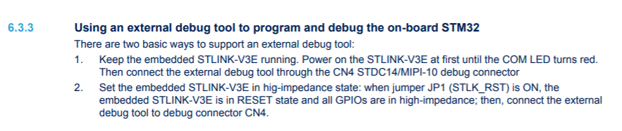

I want to do an experiment with the Nucleo-G431RB board on a jtag bus but I'm already seeing something strange. This board he has a built in ST-Link and also a jtag connector (CN4) for an external debugger. The manual says the external debugger can be used with the ST-Link disabled by putting a reset jumper on J1. But when I do this the the +3.3V to Vt goes to 0, even while I'm leaving the ST-Link USB cable still plugged in. This of course prevents the Segger j-link from connecting.
If I don't hold the ST-link in reset the Segger J-link does connect in jtag mode and does appear to work. However, I note in my Keil debugger the interface see's two devices, one the STMG431RB and the other unknown.
I eventually want to chain a 2nd Nucleo-G431 with this first one to see if I can individually control two G431's on a chained j-tag bus. Do I need to find a way to disable the ST-links? Why would a reset (conn J1) cause 3.3V to shut down.

This is in the UM2505 Manual on the G431 Nucleo board:
#1 does work but the j-tag see's two devices, the G431 and an "unknown"
#2 does NOT work. With JP1 in place there is no +3.3V at CN4-3 (Vt).
Is +3.3V at CN4-3 supplied from the SEGGER debugger, or is it just sampled? If sampled, where is +3.3V sourced from?

Answering my own question,
With the JP1 reset jumper in place I don't think the +3.3 supply gets the enable signal from the ST-LINK MCU.
I changed the JP5 jumper to +5V_CHRGR and left JP1 with the reset. Now both MCU's power up. The J-Tag still only recognizes one MCU however. As a note the J-Tag see's two devices in that MCU which I understand is the M4 core and the FPU. So chaining two G431 MCU's should result in seeing 4 J-Tag devices.
