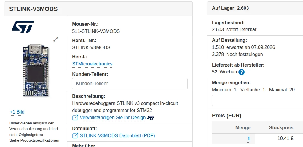

Possible - but probably not worth the effort, as a V3 miniE  or mods is just about 10 eu :
On the V3 mods you have to solder a connector or just some wires to connect to the [3.3V, SWDIO, SWCLK, GND] .

short: no.
long: this nucleo series with st-link V3 have debug connector, but just to connect external debug to the nucleo:
So you have to cut some connections and disable U545 nucleo cpu , to use the connector signals as debug of another cpu.
