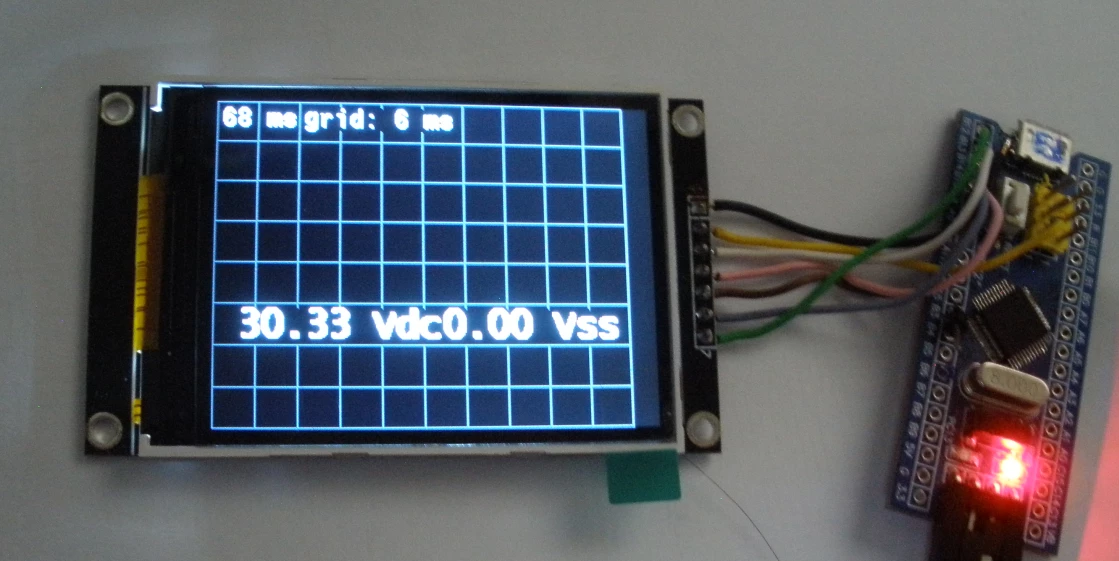

If want to see, how its done (by others ), look on git :
https://github.com/search?q=ili9341%20stm32&type=repositories
Look, how they do - or copy a lib, that seems fine for you, and try to adapt/ get it running.
Then it might look like my ILI9341 TFT + F303 here:
