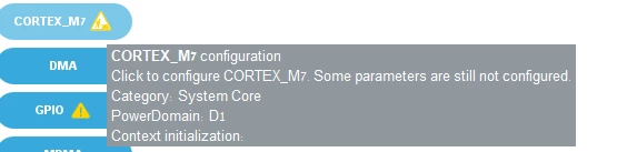

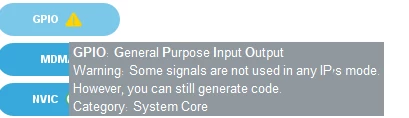

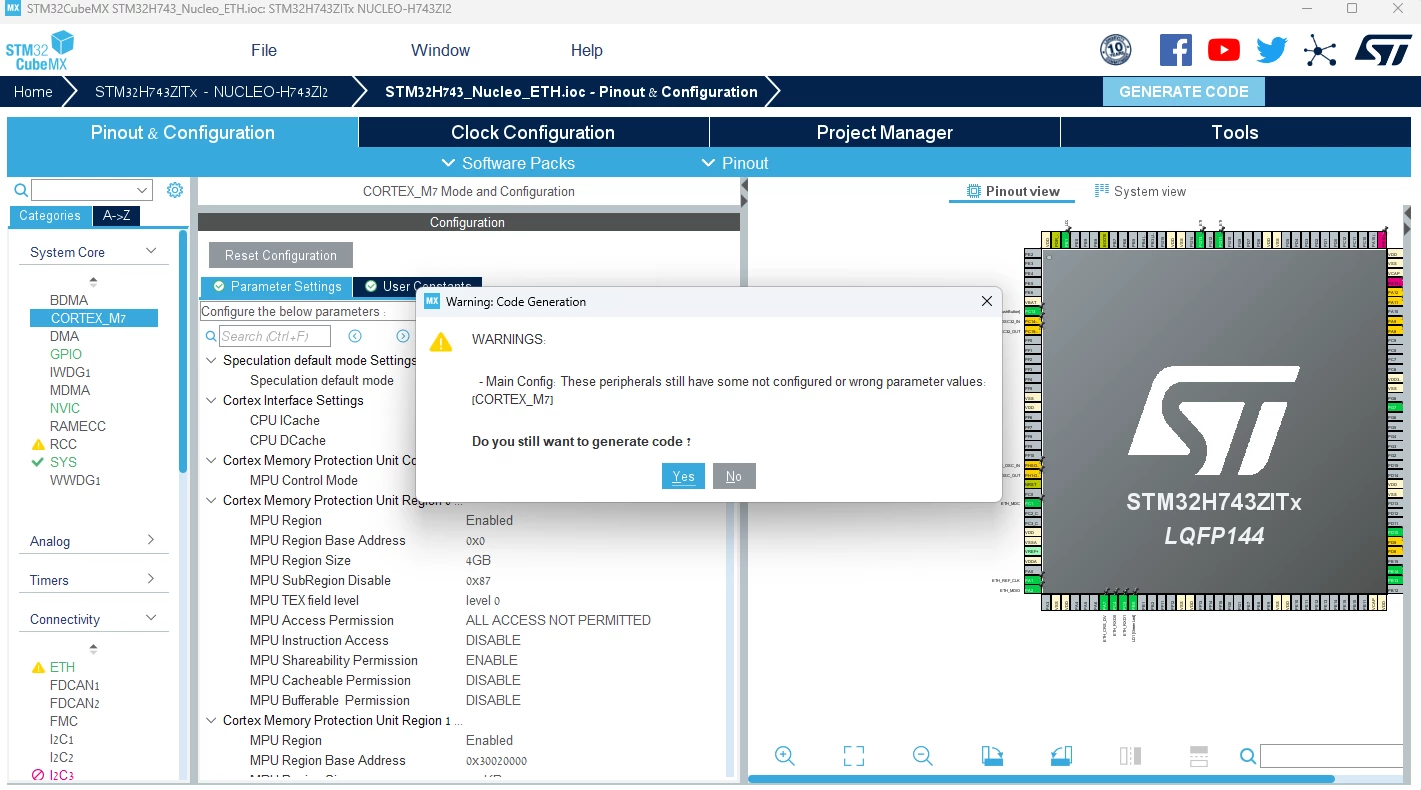

Im trying to generate the code from the same mx version that used in the example:
MxCube.Version=6.5.0
And getting the following warning:
Can i just ignore it?
Thanks alot!
Pavel A.
April 7, 2025
Sorry if the explanations were not clear enough. When you use a ready example - just build the example _as is_ and run it.   Cube is not yet known to generate a project with ETH that work without manual editing :(
It is more complicated that it should be :(
Ariel1Author
April 7, 2025
Thanks alot Pavel,
Do you mean i need to ignore the MxCube Orange/Red warnings and just try to build it as it is?
I  tried with the new versions of HAL and IDE and no luck):
I will try with the specific versions again):
Is it possible to download 2 different ide versions?
Its so complicated to run a simple example):
