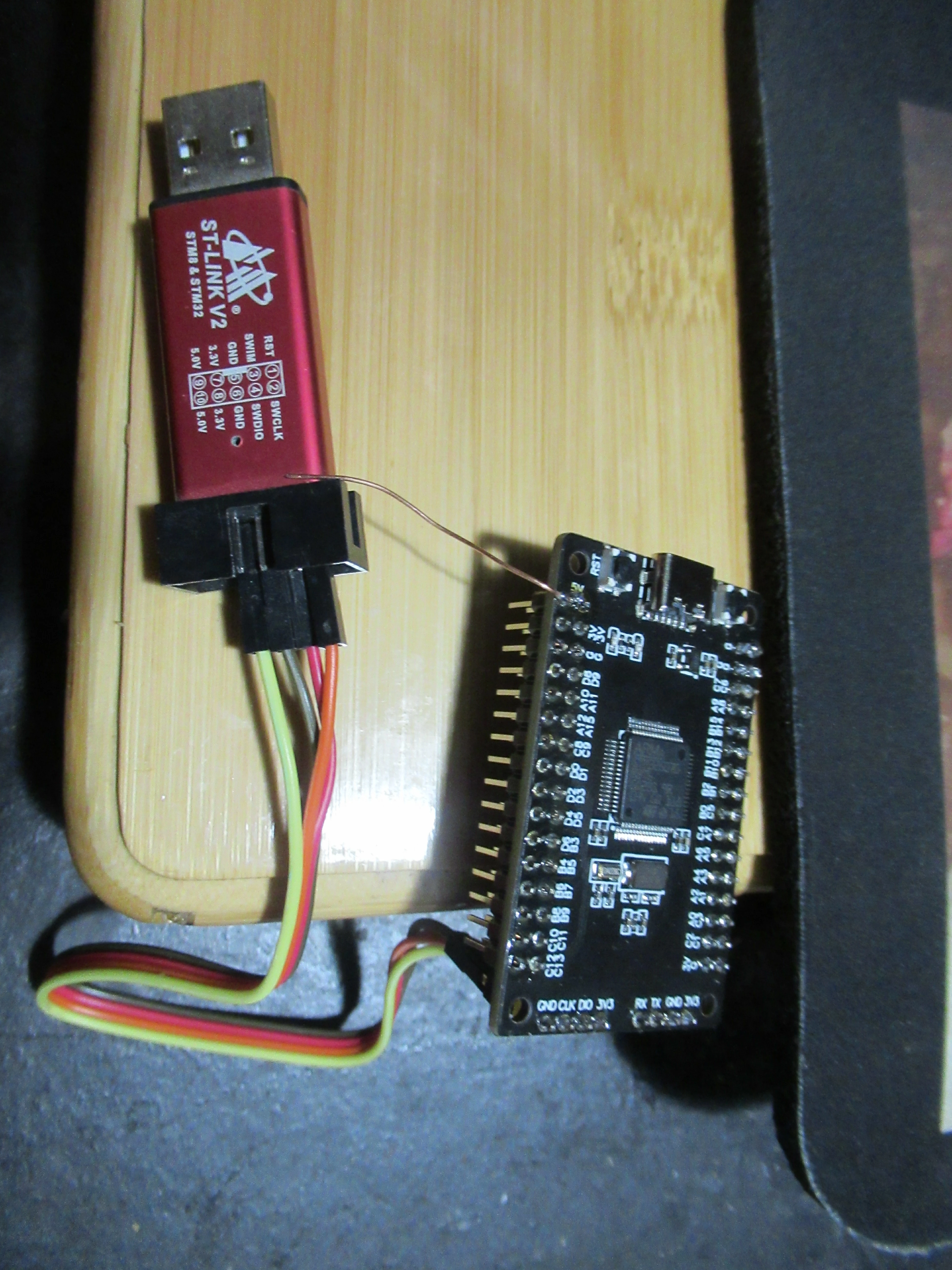

I bought a $4 Aliexpress STM32G070RBT6 board. I have a program that uses various UARTs, timers, pins, etc. The CPU should be unprogrammed since the board is new. For all I know, the CPU may be counterfeit, but usually these sort of Chinese boards work. I use my laptop to program an STM32F7 (presumably genuine) MCU all the time, so ST-link works on my setup. But when I try to download my G0 program using Keil, it says there is no ST-Link. Does anyone use these very common, widely used Aliexpress boards? If so, can I program through the USB connector. Is there anything special that I should be doing?

Do you have an ST-LINK?
Do you see it in Device Manager?
Random AliExpress boards aren't likely to have an on-board ST-LINK.
You might hope of a BOOT0 pin, jumper, or button, to get the board into a System Loader mode, where you could use STM32 Cube Programmer via USB/DFU mode or COM/UART mode.
Alternatively you have an ST-LINK and you can connect it to the SWD header, or SWDIO/SWCLK pins.

OK I think I understand.. the USB connector can only be used to deliver power to the G0 board. SWDIO and SWCLK use GPIO pins, so I must figure out which pins they connect to. Sorry to both you folks. Of couorse if anyone has already figured everything out, please feel free to share.

I have an ST-Link gadget that is very old but used to work. I'll try it on the G0 board. Thanks for your help. I won't close this thread yet because I may still be painted into a corner.

Provide a picture or link to the board you're talking about.
If you have a schematic, even better.
ST-LINK/V2 with current firmware should work with G0 parts
I wouldn't expect ST-LINK Utilities to work, but STM32 Cube Programmer should support G0

I haven't used the ST-Link gadget shown in pic for 10 years, so I'm back to being a newbie.
Connected 3.3V, SWCLK, SWDIO, GND. but not BOOT0. Keil says need to upgrade, when I say yes then msg about not in DFU mode.. If refuse upgrade, Keil says "command not supported". Device Mgr says STM32 ST-Link V2. Maybe I need to use BOOT0, which is not one of the G0 board programming pins. Maybe I need to google more, experiment more. 10 years ago, I got all this working on an old STM32 board.

Watch out for power supply: As there is an USB connector, there is probably a voltage regulator present. Then the STLink's 3.3V should NOT be connected to the board (if it's an STLink clone as on the photo), otherwise the regulator will be back-powered. But then you need USB for power supply.
The BOOT0 pin is rather irrelevant as long as SWD is used.
