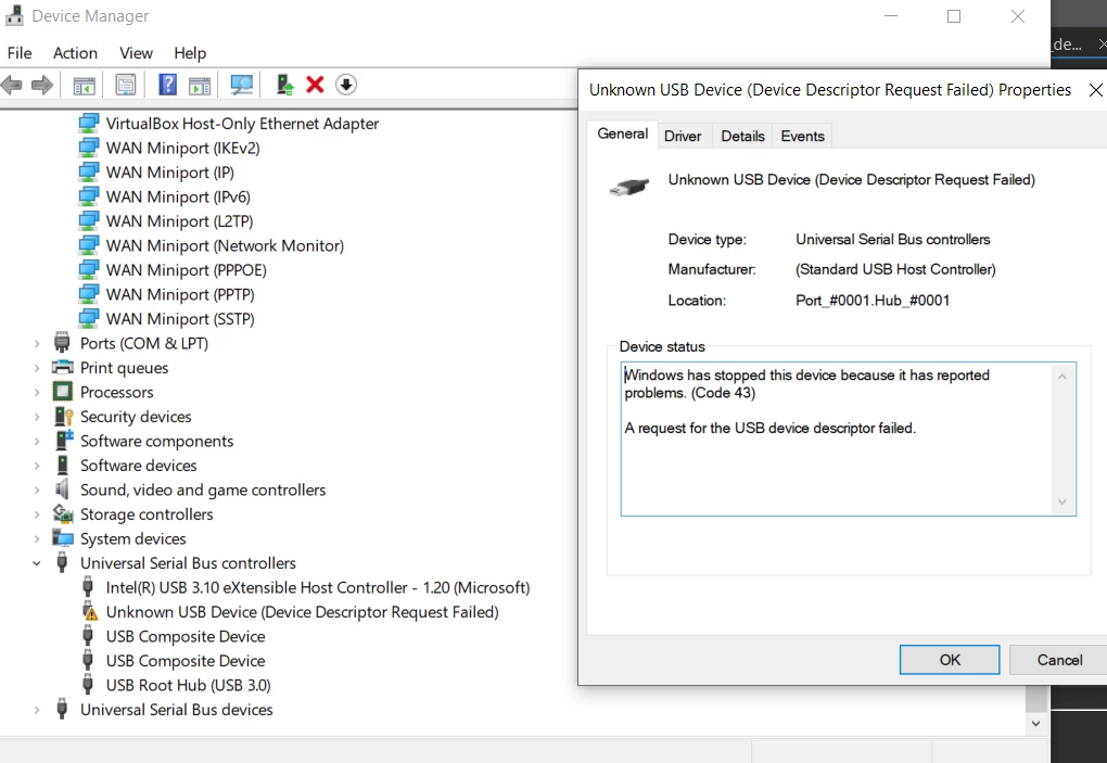

However, when I flash the code with similar configurations to the STM32U5G9J-DK1, it fails to enumerate properly. In Windows Device Manager, I get:
Windows has stopped this device because it has reported problems. (Code 43)
The USB device returned an invalid USB device descriptor.
How can I fix this?

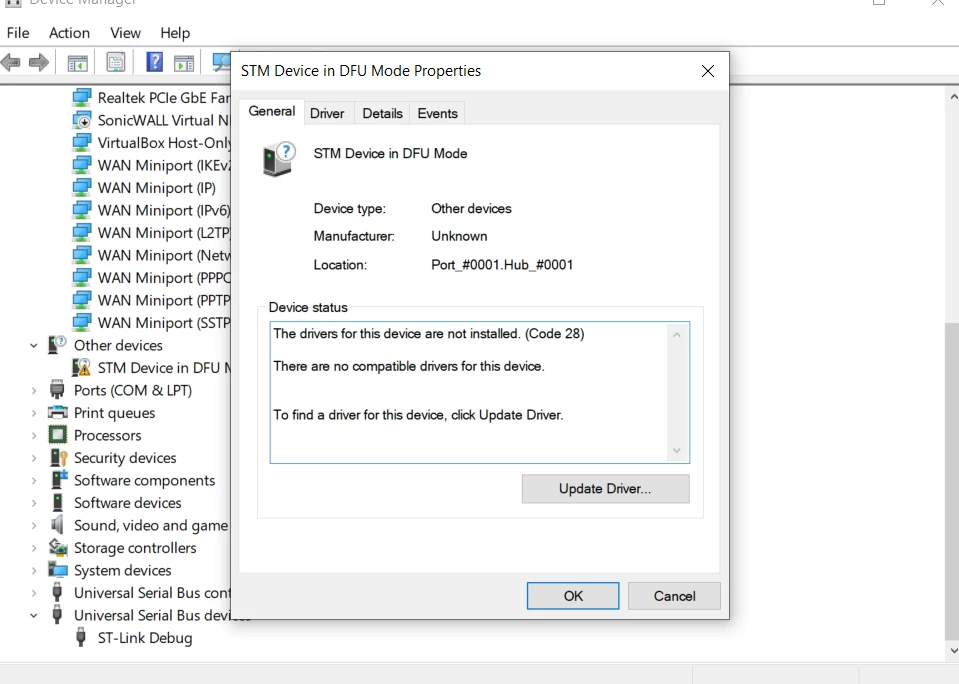

The image below shows how the DK2 device in DFU mode is recognized in Device Manager:

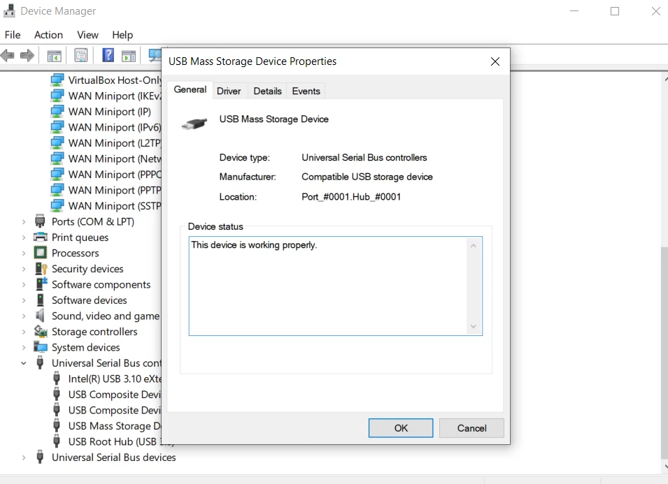

I had just changed the mode from DFU to MSC and that worked fine on the same board (DK2):
For DK1, this is what I found:
