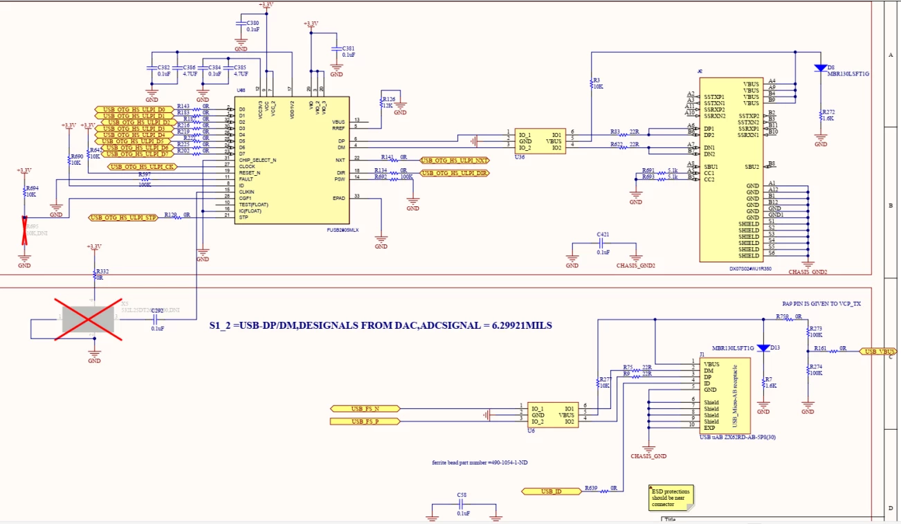

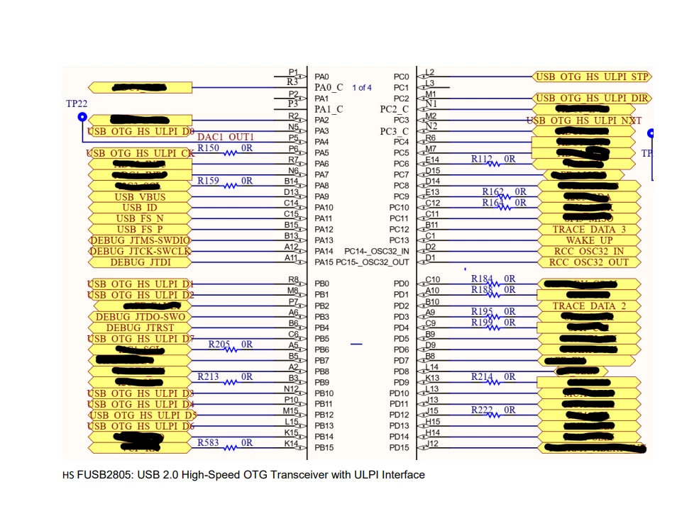

MDeva.1Associate III4 years agoDecember 31, 2021QuestionUSB HS and FS pin locking of STM32H745IIK mapping1 reply1042 viewsHello,I am working on STM32H745IIK controller.I am enabling the FS and HS USB configuration.The pin mapping that I enable is correct or wrong can you please guide me.I am sharing its pin mapping can you please just help to corrects its pin mapping.USB_HS.pdfSTM32H7 seriesUSB
