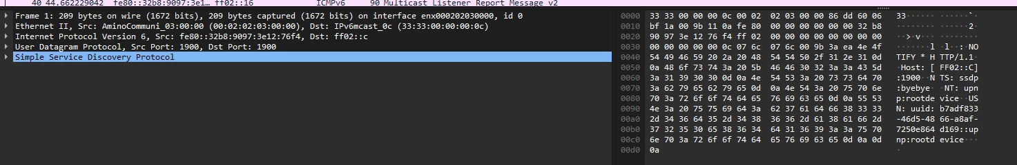

Yes, I would not fiddle or play around with the Incoming Data, I would like to Just Receive the RAW Ethernet Packets in its correct fragmentation/format.
i.e. I would like to just receive these Hex values (Captured from Wireshark),  as it is at every interrupt/packet.
