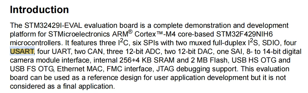

The user manual (shown as the screenshot below) for my F429 eval board says it has 4 USART ,4 UART. But I can only find 1 DB9 male port marked as USART1.

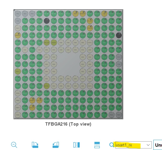

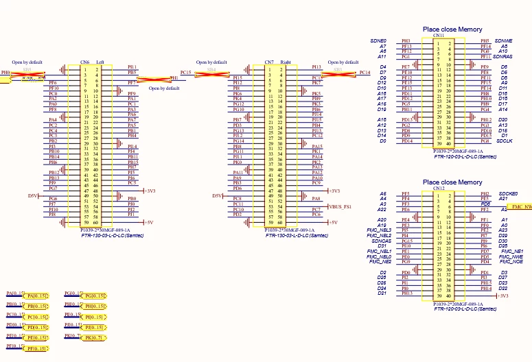

Also, when I use CubeIDE to configure USART1, it automatically enabled PB6 and PB7 for TX and RX. But on the user manual , the schematic clearly says RS232_TX for USART1 is PA9, RS232_RX is PA10.

Yes, the STM32429I-EVAL board provides only USART1 via the RS232 or IRDA connection.
Other might be possible via the pin headers, but most everything looks to be committed to screens, external memory,etc.
I think this uses the ST-LINK/V2 and predates the V2-1 model with the VCP support. It's a rather old board design, originally from 2013
This text relates to the STM32F4 chip that has so many U(S)ARTS. The EVAL *board* has only one USART1 routed to to the connector.
>I am not able to find 4 USART connections
You can find some other U(S)ARTs with "free" pins (not soldered to other functions) and make your own connectors.
The board user manual (pdf file) has reference of all pin assignments of the STM32F4 on the board.

Under CAD Resources on the product web site page, you can find the schematic for the board.
There are lots of microcontroller pins that can be accessed via connectors.  I think you will have to determine which ones can be used for USARTs / UARTs and are not connected to something else on the board.  The USARTs / UARTs accessed via these connectors will not be RS232.

If you start a new project using Board selection and use the default settings, it selects the correct pins for USART1.
If you start a project by MCU, then it may select other pins.
If you search for USART1_RX and USART1_TX, you can see by the black pins which ones are possible for selection.
If a reply has proven helpful, click on Accept as Solution so that it'll show at top of the post.CAN Jammer an open source CAN bus hacking toolCANableV3 Open Source
May 28, 2025 7:54 PM UTC
Thank you.
I do see both pins (PA9 and PB6) were highlighted when I typed USART1_TX.
I guess I can use either one of them as TX?
