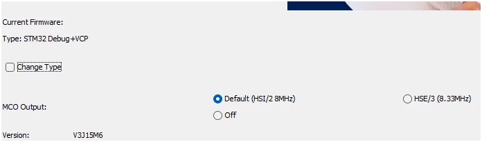

Im using the nucleo-h743zi2 and im facing the following issue:
When trying to printf using redirect to usart3 with the following clock settings:
 * The system Clock is configured as follow :
 * System Clock source = PLL (HSE BYPASS)
 * SYSCLK(Hz) = 400000000 (CPU Clock)
 * HCLK(Hz) = 200000000 (AXI and AHBs Clock)
 * AHB Prescaler = 2
 * D1 APB3 Prescaler = 2 (APB3 Clock 100MHz)
 * D2 APB1 Prescaler = 2 (APB1 Clock 100MHz)
 * D2 APB2 Prescaler = 2 (APB2 Clock 100MHz)
 * D3 APB4 Prescaler = 2 (APB4 Clock 100MHz)
 * HSE Frequency(Hz) = 8000000
 * PLL_M = 4
 * PLL_N = 400
 * PLL_P = 2
 * PLL_Q = 4
 * PLL_R = 2
 * VDD(V) = 3.3
 * Flash Latency(WS) = 4

Only works when im doing firmware update to 5MHZ HSE.
I tried to configure a setting trough stm32cubeMX with 8MHZ as input and 400MHZ as Sysclk  but got only garbge when printing.
I add this code + the stm32h..msp file to my src to the lwip_netconn_rtos example
Any ideas or explaination would be awosome thx!

> RCC_HSE_BYPASS
The clock rate used in the calculations will need to match the clock rate coming in. You do this by setting HSE_VALUE in the code, or on the left in the IOC clock tab.
The clock rate coming in from the st-link is typically 8 MHz, but this can also be changed via the firmware upgrade tool.

Yea thats the weird  thing is that when trying to config with 5MHZ input +400MHZ sysclk in stm32cubeMX and using these settings the printf is outputting garbage.
And when using 5MHZ and the settings i sent above it output correctly🥲
Any ideas what could make this happen?
Maybe other settings in this example that i miss? https://github.com/STMicroelectronics/STM32CubeH7/tree/master/Projects%2FNUCLEO-H743ZI%2FApplications%2FLwIP%2FLwIP_HTTP_Server_Netconn_RTOS%2FSrc

Is your st-link clock set to output 5 MHz? Sounds like it is.
Open stm32cubeprogrammer, go into firmware upgrade.

The problem is that the bypass HSE clock source going from the ST-LINK has two options: the default is 8.0 MHz but its source is HSI - which is imprecise. If you want the precise HSE - then the frequency will be 25/3 = 8.3(3).
With the latest firmware you can select  also HSE/5.

You can also use 5MHZ HSE -
https://community.st.com/t5/stm32-mcus/how-to-use-stlink-v3-mco-output-on-nucleo-boards-as-a-precise/ta-p/723361
I Hope it will help you also (:

Is HSE_VALUE defined in the Eclipse project preprocessor defines? Defining only in hal_conf.h is not enough IIRC. I don't remember why exactly.
Yep I stand corrected, thanks.
