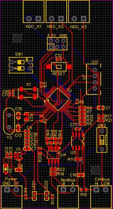

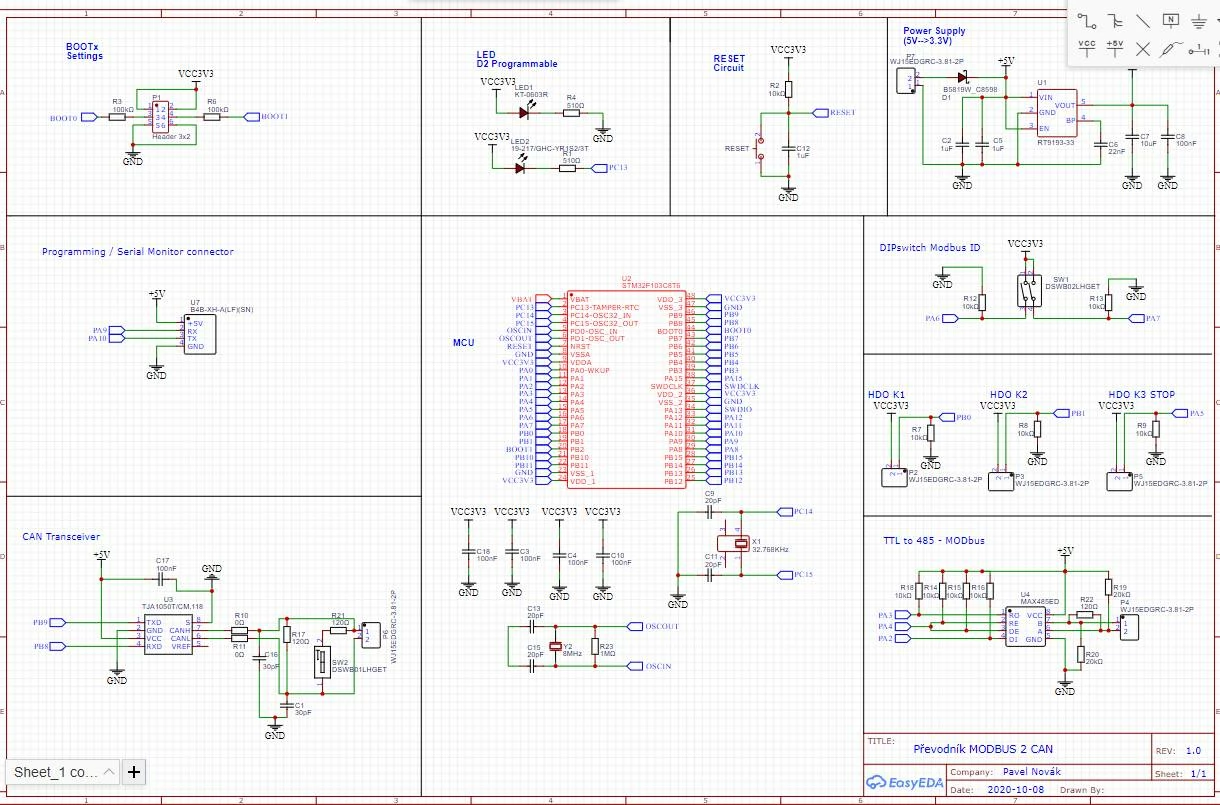

The non-crystal side of C13/C15 needs to be grounded, not floating.

BTW: you should not copy circuits from Bluepills, Blackpills, etc., as many details are not implemented correctly. For example, no pull-up to /NRST (R2 in your case) is necessary or even counterproductive.

Hello @Peter BENSCH​ , thank you for the answer. The source of the chip is https://jlcpcb.com/partdetail/Stmicroelectronics-STM32F103C8T6/C8734, so I hope, it´s original. You´re true that I copied a part of bluepill schema and probably with a mistake. If I bypass the R2 resistor, nothing change. :( Appreciate any help.

The placement of 100n capacitors as well as of oscillators and their capacitors on the PCB is very, very wrong. The microcontroller may be unable to run at anything > 8 MHz from its internal HSI because of effectively missing power decoupling. Try to start testing with HSI used as clock sorce (no PLL). The firware may be stuck in HSE/PLL init routine.

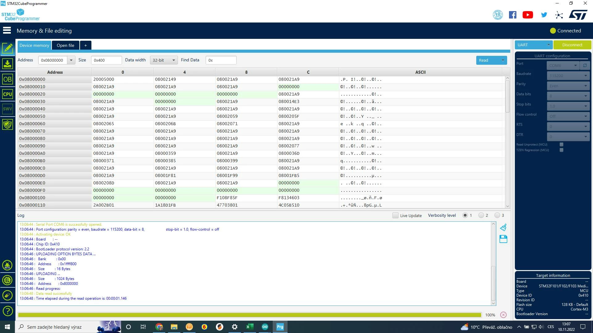

Here are data from programmer, I don´t know if it is original:0693W00000WI0C6QAL.jpg

Hi @TDK​  Thank you very much, the missing ground was the reason!!!!!

Remove the R23 and R2, replace the C12 with 100 nF. Also R3 and R6 are recommended to be 10k, but that should not be an issue. And read the AN2586.
