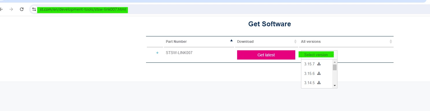

I can see that we can upgrade the st-link firmware for STM32 boards via STM32CubeProgrammer, ST-LINK Utility or STSW-Link007 tool. But I have observed that this will always pick up the latest version which is available. How to update to a specific st-link version?

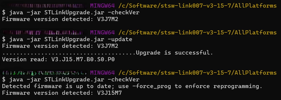

Above image (for H743) shows how I checked the version and updated it via command line. But this seems to pick up a fixed version. It seems that the versions are linked to the STLinkUpgrade.jar file. Is this correct?

You can download needed version and install :
You can downgrade also with this way
Tim
hrm_2519Author
August 9, 2024
I don't mean the software version of stsw-link007. I mean the stlink firmware version which is there on STM32 boards. The one which has format as V3J17 etc.

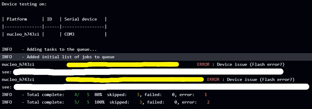

@Mike_ST We upgraded all the H7 boards connected to our agent machines to V3J15M6 version. We are running twister tests on pipeline.
But still, we are getting this error. Locally this error doesn't occur. Any suggestions would be really helpful.
