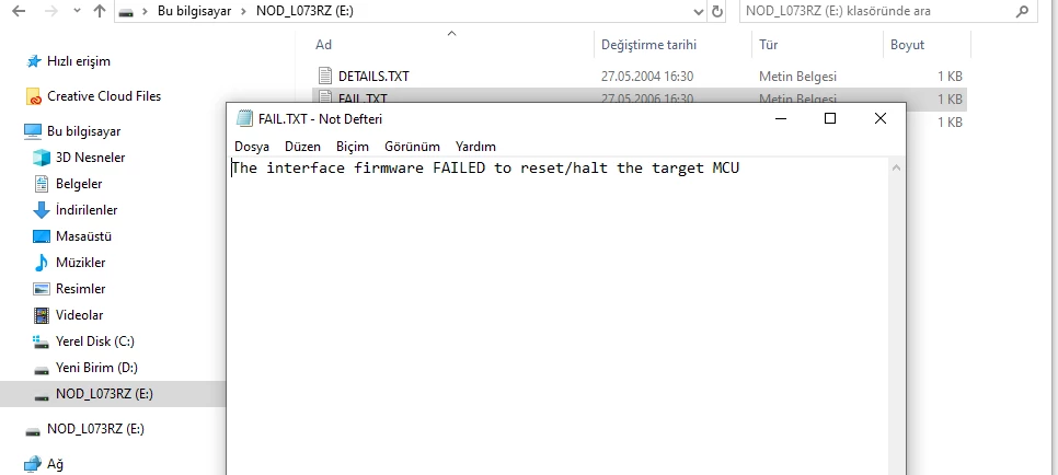

Hello everyone, i am currently working on STM32 NUCLEO-L073RZ Projects with Ardunio Ide. I did not change anything from yesterday only i install mbed studio and after installation i delete. I did not do anything with mbed just installation,  and i took these errors attached with pictures. There are also Fail.txt file in Disk. How can i solve problems. All jumpers are located in correct place.
Sketch uses 8024 bytes (4%) of program storage space. Maximum is 196608 bytes.
Global variables use 868 bytes (4%) of dynamic memory, leaving 19612 bytes for local variables. Maximum is 20480 bytes.
"C:\Users\alpal\AppData\Local\Arduino15\packages\STM32\tools\STM32Tools\1.4.0/tools/win/massStorageCopy.bat" -I "C:\Users\alpal\AppData\Local\Temp\arduino\sketches\03AC7BC7F6E3ABB77F4268DAA235E17A/sketch_may14a.ino.bin" -O "NODE_L073RZ"
Insufficient disk space on current disk.
Insert another disk and type <Return> to continue...
Insert another disk and type <Return> to continue... Failed uploading: uploading error: exit status 2Ekran görüntüsü 2024-05-14 190908.png

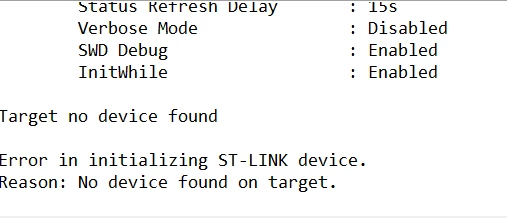

I wonder if you've crashed the chip, or stuck it in low power mode
Jumper BT0 and VDD (ie BOOT0=HIGH) so that it boots the system loader rather than user space code.
See if you can connect in STM32 Cube Programmer, and then mass erase part.

May 14, 2024
I added STM32CUBE IDE pictures i am taking another errors as you can see

Andrew Neil
May 14, 2024
So what does that file tell you?
What "disk" is it on?
