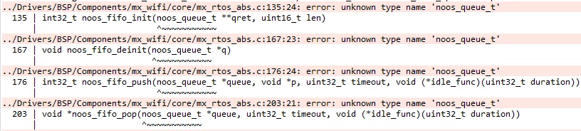

I'm willing to use the MXCHIP EMW3080B wireless module on the B-U585I-IOT02A in a project with TrustZone enabled. As there is no tutorial for that, I copied files from the Nx_Network_Basics example.
Unfortunately I get the following error when building the Non-Secure project: unknown type name 'noos_queue_t'
Your help will be much appreciated, thanks!
Seems that you omitted to copy the file which defines this type!
You need to go back to the original, and find where it was defined.
Or, perhaps, the definition is there, but is disabled by a #if due to some configuration
In that case, do a text search for  "noos_queue_t" through all the source files (both .c and .h) to find where the definition is, and then see what configuration you need to add/change.

Hello @SedCore ,
It seems to be that you are missing some .h files which could be forgotten or not been copied manually my recommendation is to start your project based on the ioc files config provided in the NX_Network_Basics with the Trustzone activated and the BSP and middleware component assigned to the correct world (secure /non secure) because some of the include files could be referenced in the drivers folder of the repository containing the example and not copied in the project itself so instead of copying you should set the same paths found in that project to get reed of these problems.

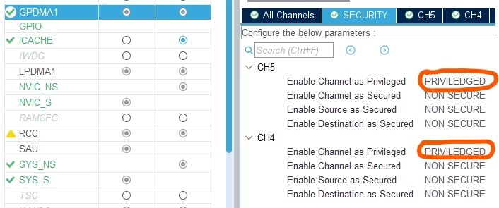

SedCoreAuthorBest answer
June 28, 2024
Hi @STea ,
I finally found the solution for using the Nx_Basics with TrustZone enabled.
GPDMA channels used for SPI communication with the MXCHIP wi-fi module should be enabled as priviledged. It is not the case with the Nx_Basics example, which is set up without TrustZone.
Thanks for your kind support!
June 28, 2024
Hello @SedCore ,
glad to hear that you found a solution for this. I 'll try to prepare a small FAQ summarizing the problem and your solution. this is mentioned in general in AN5347 in section 11.2 Using non-secure peripherals.
