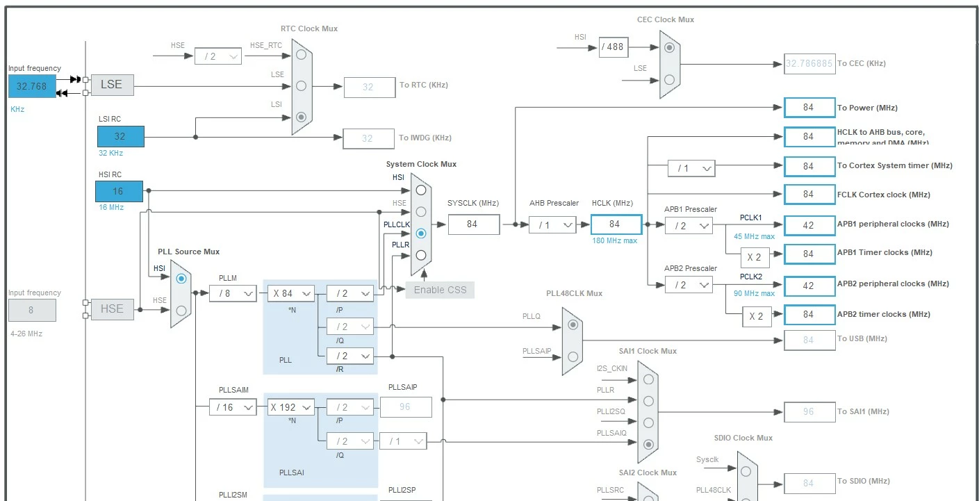

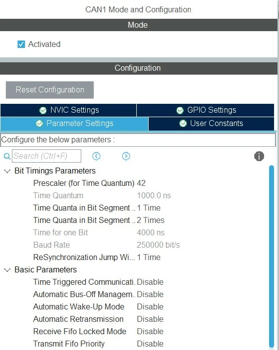

I want to use STM32F446RE to receive CAN signals from my BLDC 400 driver, which, according to the driver's documentation, uses CANopen. Since I found limited articles about CANopen on the website, I attempted to use the general CAN message reception approach. However, I have been unsuccessful in receiving the signals. I would like to ask if this method is feasible.
I want to start by receiving the simplest heartbeat, using the COB-ID: 0x71E.
I have attached the code that I have been using along with the screenshots of my timer and clock configurations.

void SystemClock_Config(void)
__HAL_RCC_PWR_CLK_ENABLE();
__HAL_PWR_VOLTAGESCALING_CONFIG(PWR_REGULATOR_VOLTAGE_SCALE3);
RCC_OscInitStruct.OscillatorType = RCC_OSCILLATORTYPE_HSI;
RCC_OscInitStruct.PLL.PLLSource = RCC_PLLSOURCE_HSI;
RCC_OscInitStruct.PLL.PLLM = 8;
RCC_OscInitStruct.PLL.PLLN = 84;
RCC_OscInitStruct.PLL.PLLP = RCC_PLLP_DIV2;
RCC_OscInitStruct.PLL.PLLQ = 2;
RCC_OscInitStruct.PLL.PLLR = 2;
Error_Handler();
RCC_ClkInitStruct.APB1CLKDivider = RCC_HCLK_DIV2;
RCC_ClkInitStruct.APB2CLKDivider = RCC_HCLK_DIV2;
if (HAL_RCC_ClockConfig(&RCC_ClkInitStruct, FLASH_LATENCY_2) != HAL_OK)
Error_Handler();

static void MX_CAN1_Init(void)
/* USER CODE BEGIN CAN1_Init 0 */
/* USER CODE END CAN1_Init 0 */
/* USER CODE BEGIN CAN1_Init 1 */
/* USER CODE END CAN1_Init 1 */
hcan1.Instance = CAN1;
hcan1.Init.Prescaler = 36;
hcan1.Init.Mode = CAN_MODE_NORMAL;
hcan1.Init.SyncJumpWidth = CAN_SJW_1TQ;
hcan1.Init.TimeSeg1 = CAN_BS1_2TQ;
hcan1.Init.TimeSeg2 = CAN_BS2_2TQ;
hcan1.Init.TimeTriggeredMode = DISABLE;
hcan1.Init.AutoBusOff = DISABLE;
hcan1.Init.AutoWakeUp = DISABLE;
hcan1.Init.AutoRetransmission = DISABLE;
hcan1.Init.ReceiveFifoLocked = DISABLE;
hcan1.Init.TransmitFifoPriority = DISABLE;
if (HAL_CAN_Init(&hcan1) != HAL_OK)
Error_Handler();

    Your device has 2 can bus peripherals, if you connect them with each other TX1-RX1-TX2-RX2-pullup (4.7K) to 3.3 volts, you can build a very simple bus where you can send with 1 peripheral and receive with the other one. This is even more simple than doing so by can open.
    This test design was documented in "Beginning STM32" by Warren Gay p 327. It is of course not a fully blown can bus approach but for testing it can do. On top, you might consider putting a data analyses scope on your bus to see what is going on.
    But I am not sure if both can bus i/o are available on the clamps of your board, this you will have to check using RM0390 or via the Cube MX configurator.
