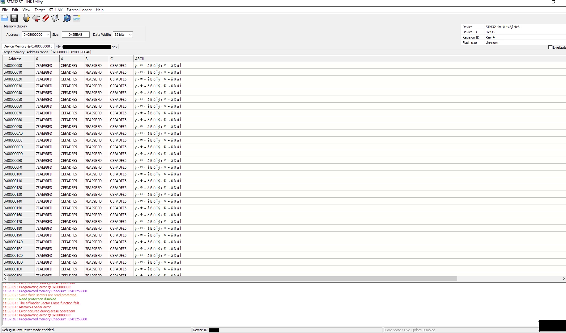

We are using STM32L476ZGTx. Until recently I was able to program the chip using ST-Link. A few hours back programming failed due to power issue and since then I have been unable to program the controller.
The device connects with ST-Link Utility every time, so I am guessing the connections are not an issue. Reading the device shows garbage , repeated at every memory location, PFA
Full chip erase gives the error "Some flash pages are read protected!"
Programming a file gives error "Programming error @ 0x08000000!" in the gui, this log in the log window

Best answer by HMahm
The device was mass erased by setting the Read Out Protection to Level 1 and then to Level 0, using ST Link->Target->Option Bytes.
Now I can flash it with the desired HEX files

Related problem,
the device was in level 0 but ST Link report the message "The elf loader Mass Erase function fails".
Setted the Red Out Protection from level 0 to level 1 than to level 0, checking the flag PCROP_RDP in the Option bytes page
problem solved
