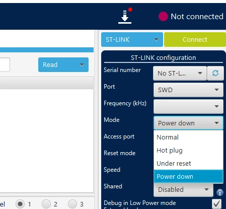

  • which specific STM32G031 is?
Im using stm32g030j6Mx without selecting SW pins and i dont have this issue
  •  Which cubeProgr version are you using?
  • Did you do the STlink configuration Mode raindance?
0693W00000YAFdEQAX.pngCheck all posibilities.

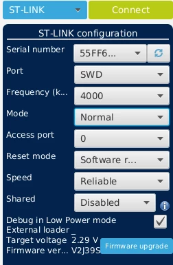

Hi Javier,
I'm using STM32G031J6M6 & CubeProgrammer v2.11.0.
I've tried right now other modes. Normal is the one of my post, hotplug has the same errors but the current doesn't change, under reset same errors & also current drop to almost 0, finally power down doesn't react at all "No STM32 target found!" at all times.
This is the ST-LINK configuration I've been using until now:
