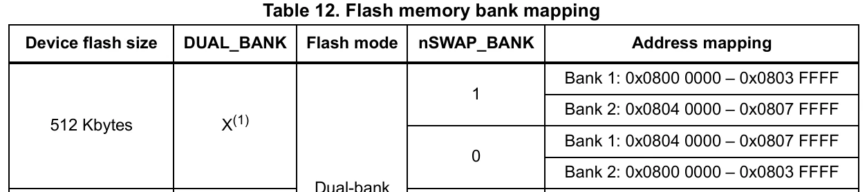

Oct 15, 2025 1:29 PM UTC
So what happens? What do your log functions output when it fails?
You should set the erase_init.Bank parameter to bank 1.

If HAL reports success, it probably erased something.
Did you fix the uninitialized Banks parameter in the code? Note that your pages are in different banks.

Oct 16, 2025 1:17 PM UTC
Did you try:
erase_init.Banks = FLASH_BANK_1;
or
erase_init.Banks = FLASH_BANK_2;
depending on where the page to be erased is.
Flash is 128 pages per bank. See "3.3.1 FLASH organization" in the reference manual.
