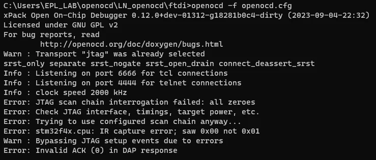

I am a newbie in using openocd and STM32 MCUs, I am trying to connect iwith STM32F429ZI board from my PC using Openocd via C232H FTDI cable using its JTAG interface.
I am encountering JTAG scan chain error, while running openocd -f openocd.cfg
I have attached my interface.cfg and target.cfg, please take some time of yours to go through them completely

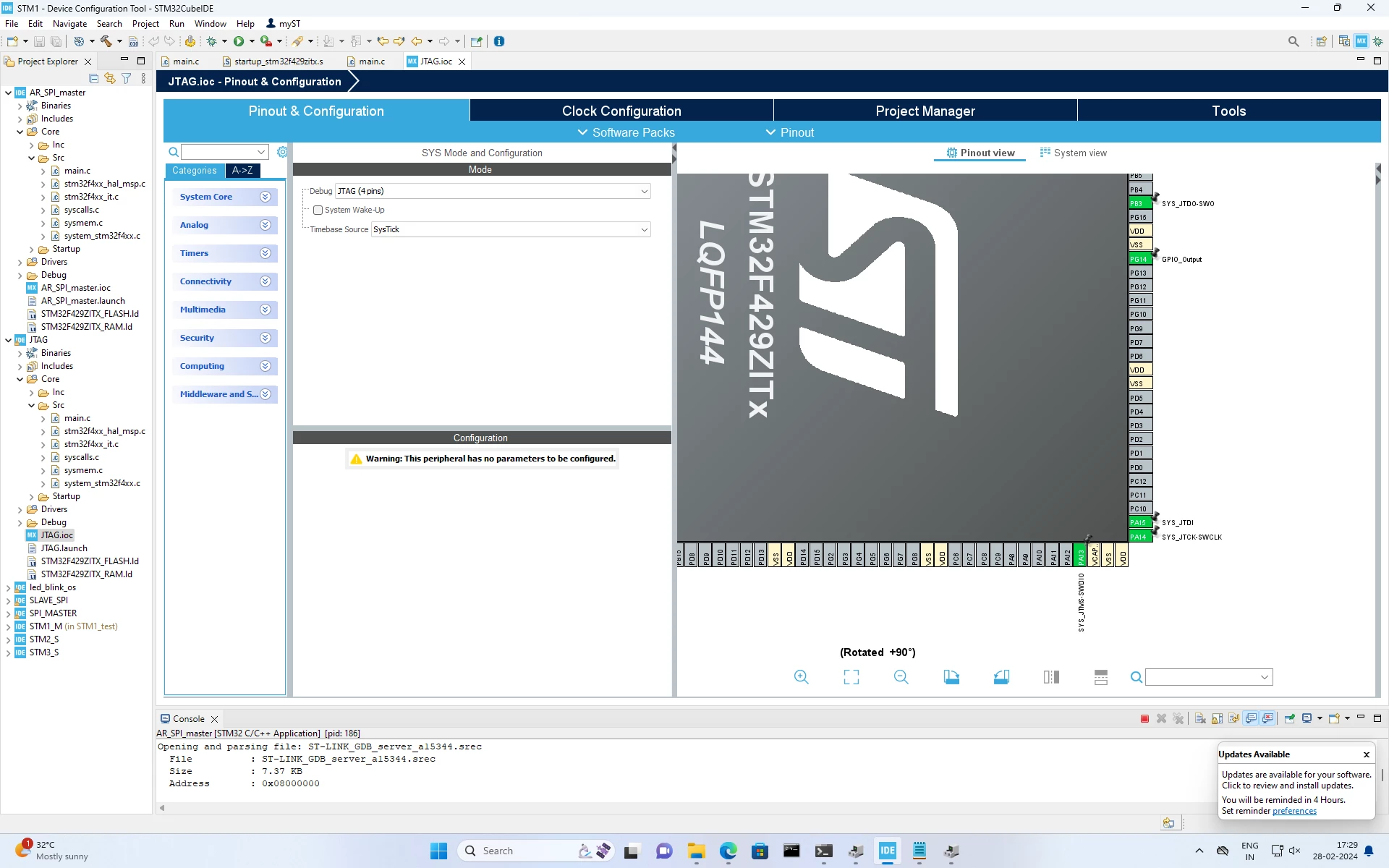

Since STM32F429ZI does not have dedicated JTAG pins I am enabling the GPIO pins PA13 - TMS, PA14 - TCK, PA15 - TDI and PB3 - TDO to behave as the JTAG pins. I am running a firmware that enables the mentioned pins to act as JTAG pins.
Firmware

Even after this setup I am getting JTAG scan chain error, I am not understanding what or where it is going wrong.
I'll be glad if someone could help me resolve this error.
