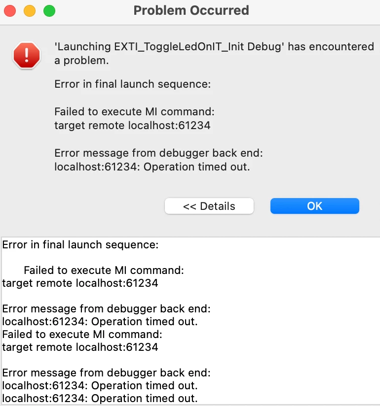

Hello Team,
I am trying to use the external ST Link V2 with NUCLEO-C031C6,
Below are the connections,
1. I have removed CN2
2. JTAG Connections are below
    1- MCU VDD to 3.3V pin of CN6
    2. SWDIO - PA13 of CN7
    3. SWCLK - PA14 of CN7
    4. NRST - NSRT pin of CN6
    5. GND - GND pin of CN6
    6. GND(16)- GND pin of CN6
I have given 5V at JP5 pin, Able to see the MCYU get power at JP6
With this connection I am unable to program the MCU, getting this error
Please help on this
    But why? The Nucleo boards have an on-board ST-Link. You only need to connect CN1 with a USB cable to power and program them.

    I want to test the SWD as it will be used in our design where STM32C0 will program via st link V2.
    Both links?

    Yes I have removed both short links.

    Try check NRST state en.MB1717-C031C6-B02_Schematic.PDF (st.com) SB23
    but from your info too problem maybe is your OS , blocked port or other issue. Simpler way is use STM utility aor programmer sw ...

    @nevase123 - on that thought:
    1. Does the onboard ST-Link work?
    2. Have you ever used this external ST-Link successfully before?
    Also, What ST-Link are you using? Is it a genuine ST one?
