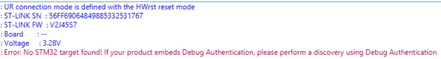

When trying to connect the board via ST-link in CubeProgrammer i get the error: "No STM32 target found!..."; can't figure out what problem is preventing ST-link from finding the target.

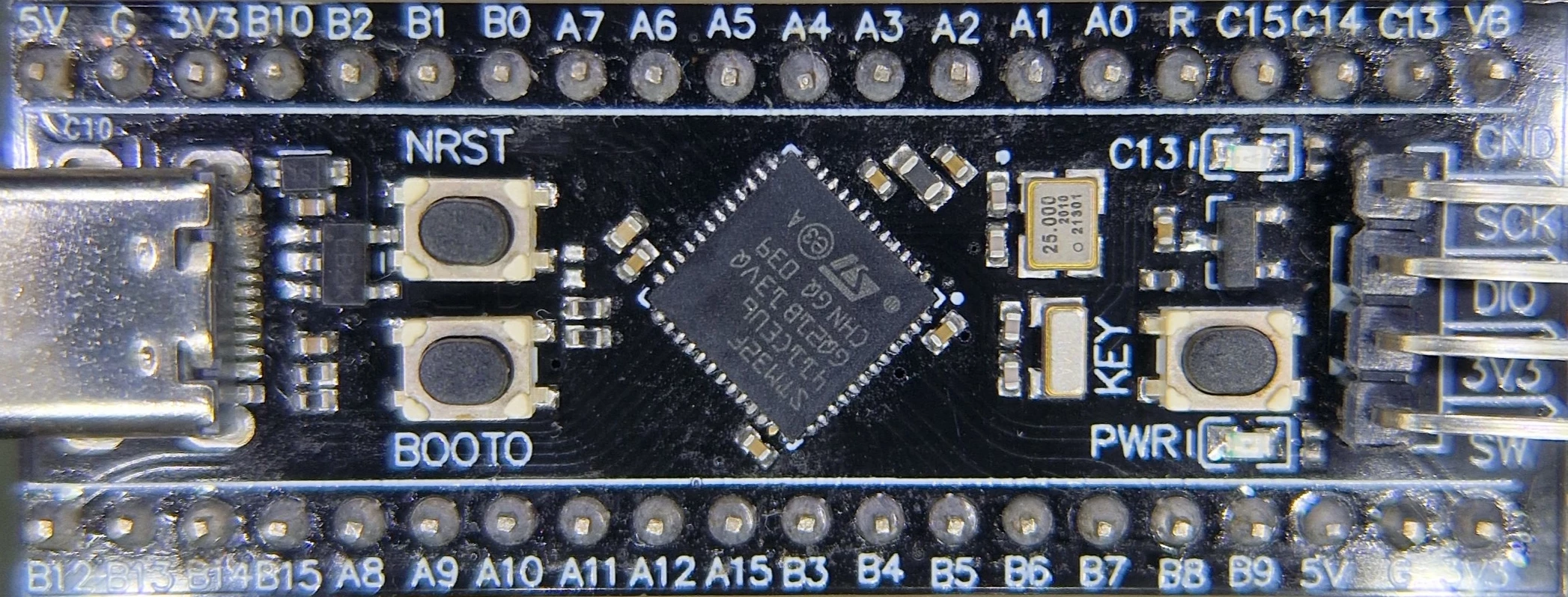

Board: WeAct BlackPill V3.0, MCU: F411CEU6 (original), SWDIO and SWCLK correctly configured on pins PA13 and PA14 (SWD configuration), target voltage 3.28V.
ST-link: V2 dongle, MCU: F103C8T6 (original), tried with reset pin connected, tried with various firmware versions (now v2J45S7).
CubeProgrammer: no mode and reset mode works, tried various versions (now v2.17.0). (ST-link Utility too).

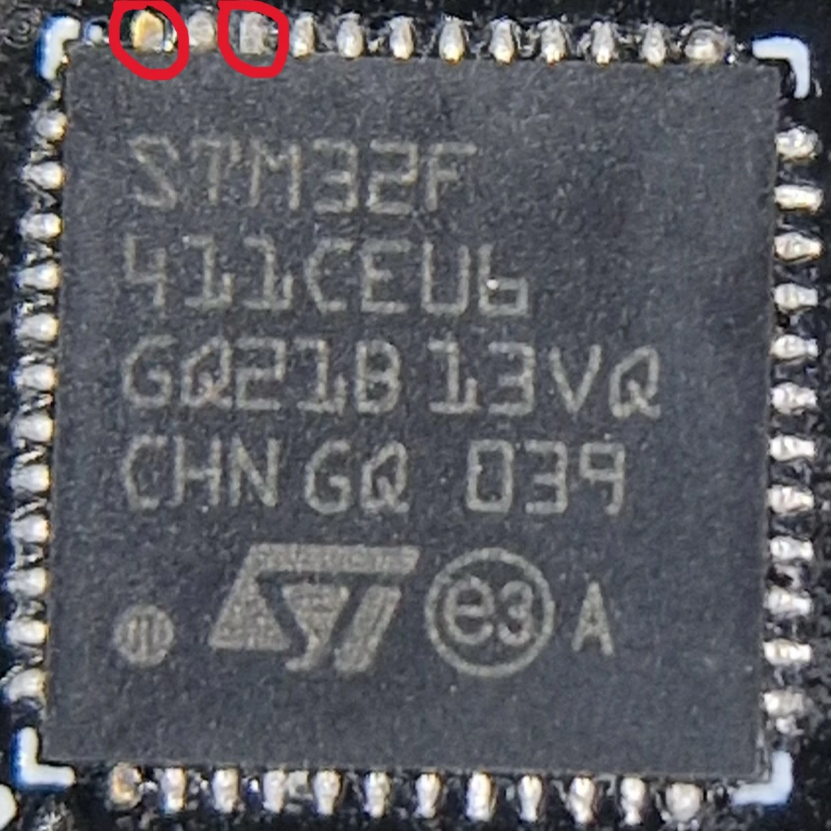

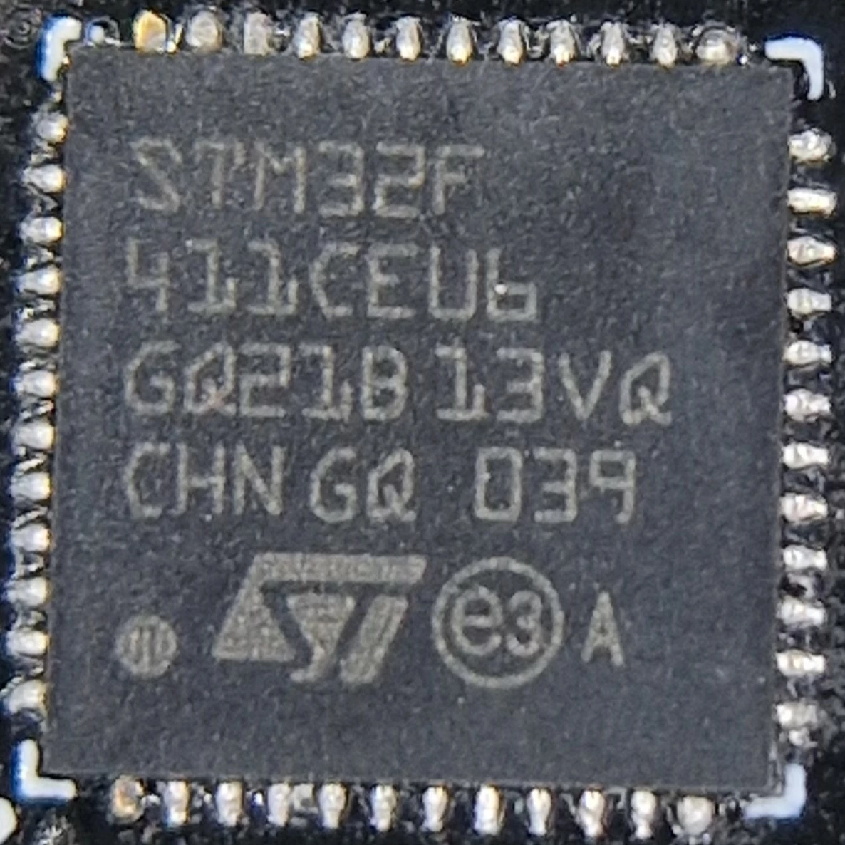

Some time ago, after checking the board, I noticed two pads not soldered correctly, coincidentally they were pin 36 (VDD) and pin 34 (PA13 of the UFQFPN48 package); but I left the hardware work as a last try, being the most risky.
Having considered all possible causes of malfunction not strictly hardware-related I decided to check this case too, trying to add solder where it was missing.

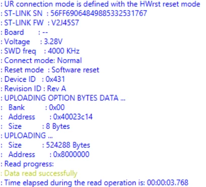

After adding it... surprise! it works flawlessly in every mode.
Seems that it was just a faulty solder, despite it being an original WeAct BlackPill.

That the part is not actually authentic?
Perhaps un-powered? Perhaps wrong pins?

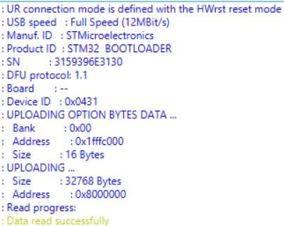

Does it present as a DFU "STM32 BOOT DEVICE" if connected via USB and BOOT0=HIGH ?

it seems an original F411 to me, maybe i'm wrong, it seems to have UFQFPN48 package correct marking layout at least.
https://www.st.com/resource/en/technical_note/tn1433-reference-device-marking-schematics-for-stm32-microcontrollers-and-microprocessors-stmicroelectronics.pdf

When connected via USB with DFU mode selected (BOOT0=HIGH) it's shown as "STM32 BOOTLOADER", a serial number is recognized too.
