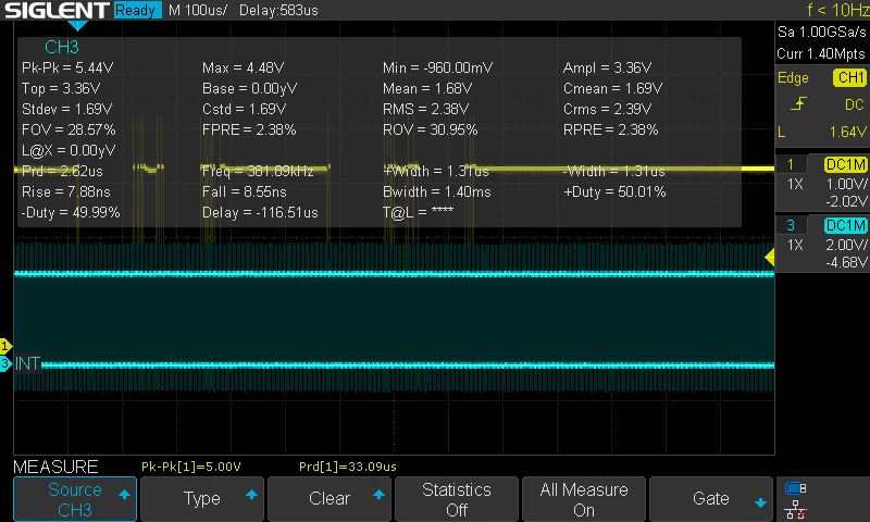

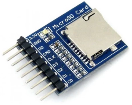

Hai All,
I want to mention my points about the SDIO protocol in the F446RE Nucleo Board.
1. First I checked the Clock frequency and verified that it is always 381 KHz all the times. The image from the oscilloscope is attached here.
2. Even if the frequency input for APB2 is divided with any prescalar value , the same 381 KHz is maintained.
It is not increasing or decreasing.
3. I have tested the same with an SDIO module which is purchased via online for hardware side verification. Unfortunately there is no change.
So , I assume that SDIO is not suitable for F446RE Nucleo or STM32f446RE microcontroller series.

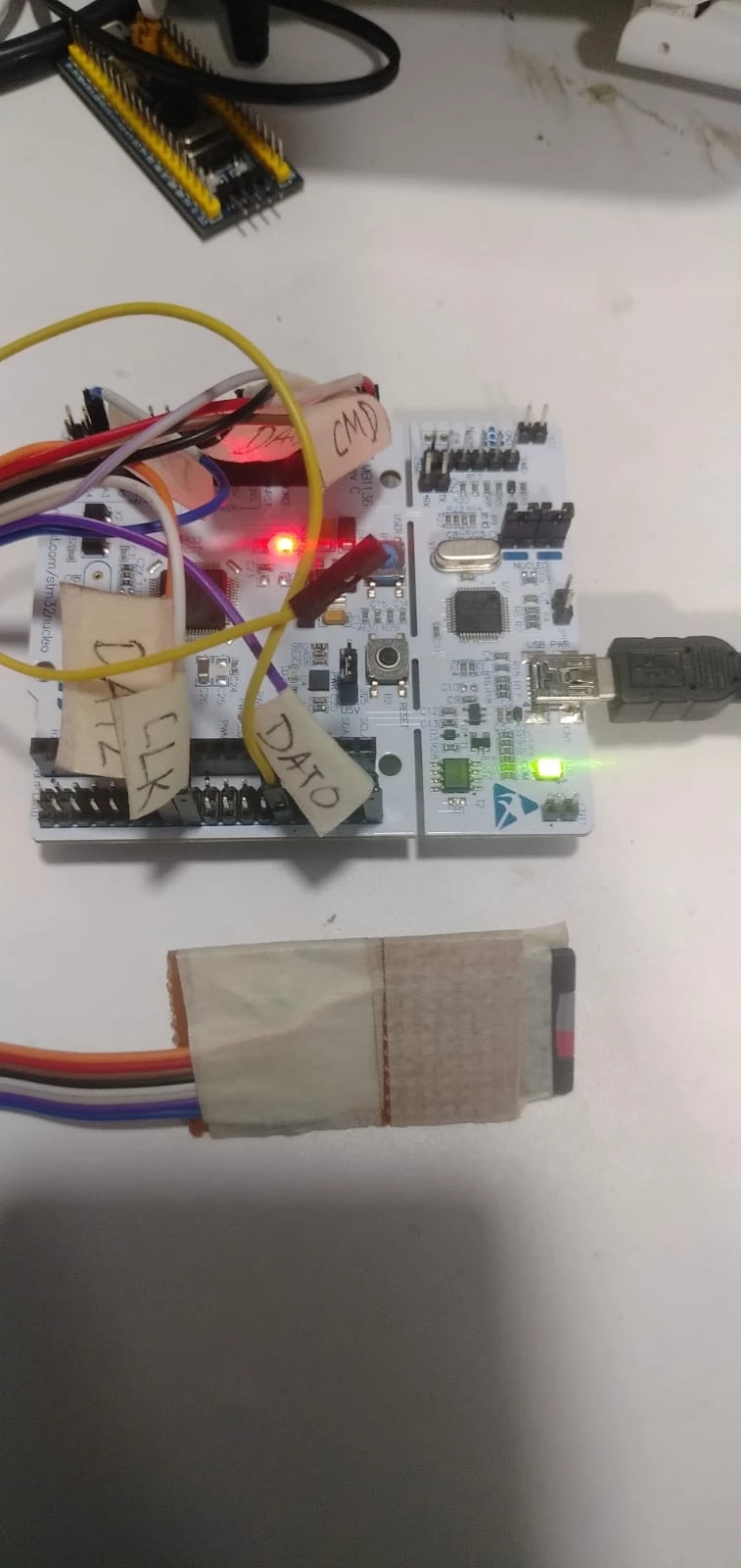

Abin
AbinAuthor
Oct 22, 2024 1:14 PM UTC
Hai,
I will explain my points clearly.
I have Nucleo f446RE board and I need to interface an SD card with the same board using SDIO protocol.
I am using SD card adaptor for connecting the SD card with Nucleo Board. Please see the image.
The connection is exactly the same as in the image.

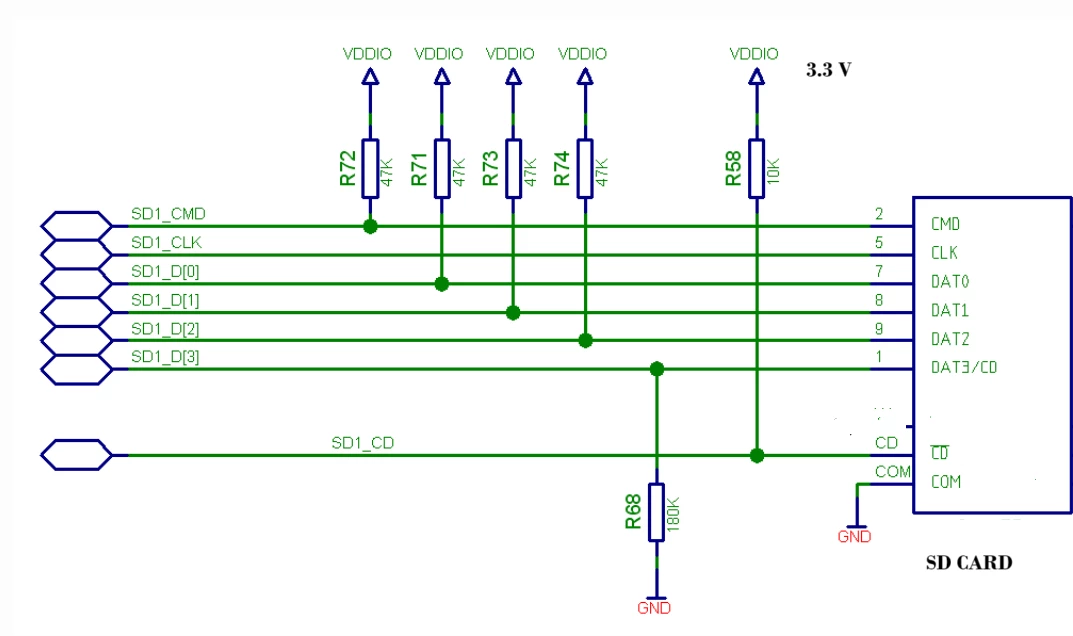

EZHON.1
Oct 23, 2024 1:18 AM UTC
Abin,
Thanks for your sharing. The schematic is no issue, even we can config internal pull-up/pull-down without external resistor to respect the SDIO specification.
I don't find the right MCU pinout for SDIO and the connection. But I think it's not the big issue if you checked them carefully.
I'm worried about the signal integrity because you used the flying wires for SDIO communication. For my understanding, it maybe the issue happens on the L446, but not on the L476. It should be better to use oscillator to confirm the signals.
If not, I suggest adding more GND wires close to SDIO signals to check if the SDIO communication can create.
Abin
AbinAuthor
Oct 23, 2024 6:32 AM UTC
Hai @EZHON.1
Thank you for your reply. I will check it. Moreover, I checked the clock frequency. It is coming as 334KHz. I configured HCLK as 16 MHz from internal RC oscillator.And the division factor is 18.This division factor is derived from the following formulae
SDIO Need 400KHz clock, So 400 = (HCLK)/(2*(CLKDIV+2)).Please confirm , my approach is correct.
