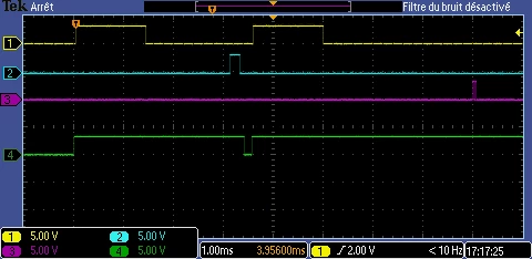

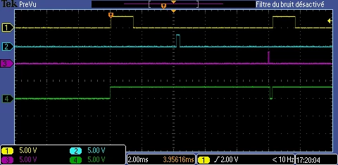

I am currently trying to receive uart message when the MCU is in stop mode on a Nucleo-L073Rz board.
To do this I first wake up the mcu on uart start bit, and when the mcu receive the uart idle event.
I can then treat the received message in the main loop before entering again the main loop.
It works great when the received message is only one char long.
However if the received message is longer, the HAL_UARTEx_WakeupCallback is called a second time after all treatment has already be done.
Which is a problem, because it wake up the MCU whereas It doesn't trigger HAL_UARTEx_RxEventCallback in order to stop the mcu again.
I am quite new in embedded software so maybe I have to make some routine or clear flag, but I have no idea.
How does I assure the HAL_UARTEx_WakeupCallback not to be called twice ?

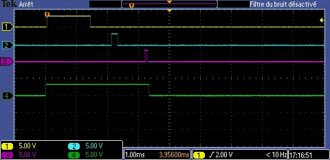

In order to follow when and how many times I entered callback function, I activate pin accordingly.
See capture bellow:
Yellow: HAL_UARTEx_WakeupCallback
Blue: HAL_UARTEx_RxEventCallback
Pink: Command treatment
Green: Run Mode

Hi TDK,
Thank you for your answer.
As I use a 20 chars long buffer, I don't think I can get overflow in data reception buffer.
And all characters are well received as I can print them in HAL_UARTEx_RxEventCallback or commandTreatment function
As you advise, I check the uart flags:
When receiving 1 char:
6291648 -> 11000000000000011000000
or
6295744 -> 11000000001000011000000 -> USART_ISR_EOBF
When receiving 2 char:
7344320 -> 11100000001000011000000 -> USART_ISR_WUF
If I clear USART_ISR_WUF flag before entering stop mode, There is no more second wakeup and all works well.
Maybe the USART_ISR_WUF is put on when the second char is received and I am maybe still in the HAL_UARTEx_WakeupCallback function ?
2 replies

Perhaps you aren't reading the incoming data fast enough and the second character causes an overflow condition. 10ms to handle a single character is a long time. Can you check the UART flags for this?
