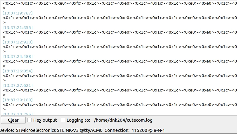

I am using a NUCLEO-STM32H753ZI-$AT3 development board.

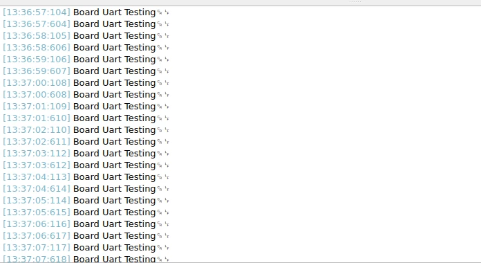

When I configure the MCU to use the internal clock (HSI), everything works correctly and my UART debug logs are printed normally.
However, when I switch to using the external 25 MHz clock (HSE), no UART logs are printed. The code runs,but the UART prints garbage characters, for example:
<0x1c><0xe0><0xfc><0x1c><0xe

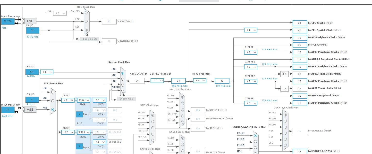

  • 25 MHz external clock is selected in CubeMX (HSE ON, Crystal/Ceramic Resonator).
  • PLL settings are unchanged except switching HSI → HSE.
  • UART baud rate is the same (115200).
  • If I go back to internal HSI, UART prints again.

    Andrew Neil
    So your baud rate is wrong.
    Use an oscilloscope or logic analyser to see what rate you are actually getting.

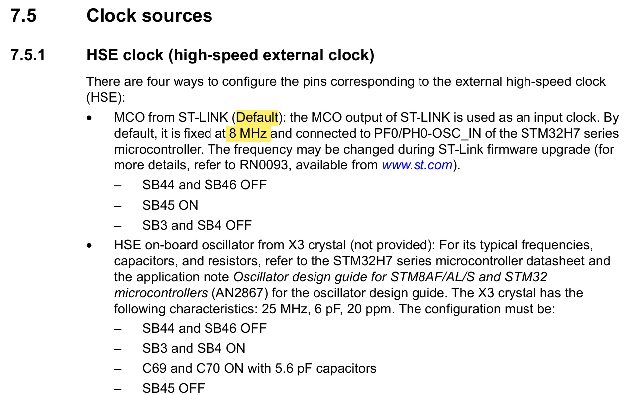

    ELABI.1
    Hi @sameer_2k3,
    Are you using an external HSE?  The NUCLEO-STM32H753 board does not have an HSE clock fitted.
     I think this may be the cause of your problem.
    You can refer to this article How to use STLINK-V3 MCO output on Nucleo boards as a precise clock source for STM32 to see how to select the frequency and configure the HSE input according to your selection.
    Thanks.
    ELABI.1
    i have connected externally 25 M
    Unless you have physically modified the board, you should select HSE bypass mode and change the value to 8 MHz. That is the clock signal coming in to OSC_IN on the target chip. The ST-link chip has a 25 MHz crystal but that is not relevant here.

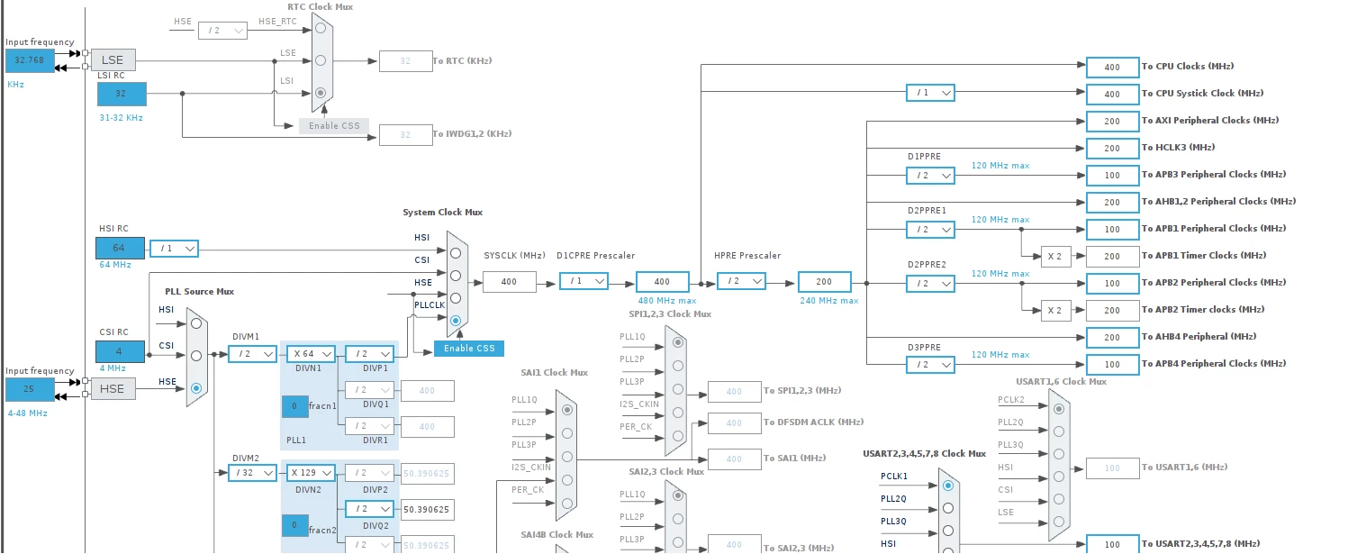

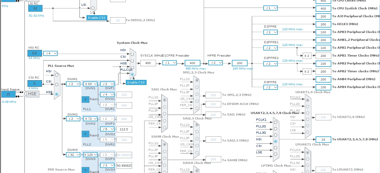

    I configured the PLL to 400 MHz, and when I select HSI as the clock source for UART, the UART logs print correctly. However, when I switch the UART clock source to the PLL in CubeMX, the UART output becomes corrupted and prints garbage characters.
    Why does this happen, and how can I fix it?
    What changes do I need to make to use the PLL clock for UART logging without getting garbage output?
    Andrew Neil
    You still have the input frequency set at 25MHz :
    You can use the MCO output to check actual clock frequency (the output pin will need to be configured for High speed)
    @sameer_2k3 Are you actually reading the replies you're getting? Or just ignoring them after reading?
    Multiple people have told you the problem in multiple different ways.
