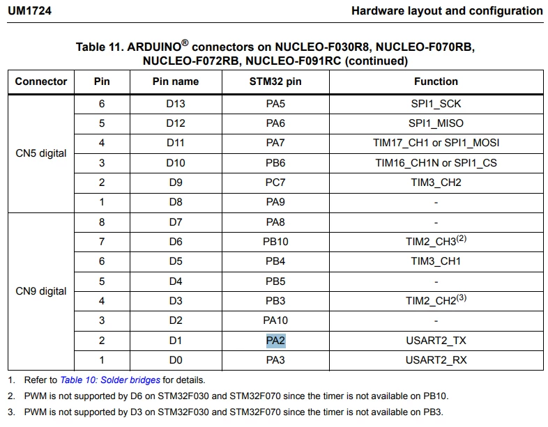

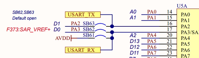

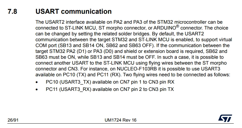

Andrew Neil
Aug 4, 2025 2:03 PM UTC
@NicRoberts wrote:
If I'm right then PA2 has been set up as a UART TX
You can confirm that in the board's User Manual:
https://www.st.com/resource/en/user_manual/um1724-stm32-nucleo64-boards-mb1136-stmicroelectronics.pdf
via: https://www.st.com/en/evaluation-tools/nucleo-f411re.html#documentation
You could also check the schematics:
via https://www.st.com/en/evaluation-tools/nucleo-f411re.html#cad-resources

Senior III
Aug 4, 2025 3:09 PM UTC
OK so the board is set up correctly for use of USART2 over the ST-Link/USB connection, I have used this before with no issue with the board but just double checked & it all looks good.
No other hardware connected.
Baud rate on the board & the terminal match (115200),
COM5: STMicroelectronics STLink Virtual COM Port selected from Tera Term pull down
.....and nothing.....
