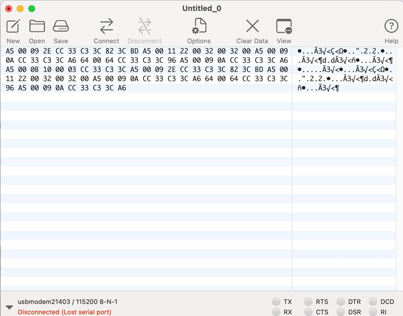

Hello Guys,
I am using waveshare 4.3 inch e paper UART display module. I looked to manual thousand time and I found a library called epd. this library was written in cpp and I rewrote for my stm32f411RE nucleo board in c and HAL Library. Buffer working good and I am transmitting hex codes to my computer. But the screen doesn't respond to these commands. I need for your help. My files and displays wiki are attached.
Thank you!!
https://www.waveshare.com/wiki/4.3inch_e-Paper_UART_Module

Not sure there are a lot with the hardware to do the debug for you.
The IsSend will need to be volatile if changed in interrupt/callback.
Perhaps add diagnostic / telemetry output via serial so you can observe the interactions between the STM32 and display. Use a scope or logic analyzer to check the hardware level interactions.

I am sending data to display via USART2 which connected both pc and display and I observed the data that board send to display. At the pc side everything fine but display doesn't respond.
wiki says there is a parity bit but it is in the library. should I set a parity bit by cube mx? but I don't know how to set that because wiki doesn't say what parity is that (odd or even).
AScha.3
March 3, 2024
You can try it - just set (in cubemx) in usart2  parity , then try.
If still no response, change odd/even and try again.
