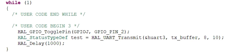

Hey everyone,
I want an UART communication between my PC and my STM32H745 Disco board.
By default the UART 3 (connected to STLINK connector) is one core M4.
My baud rate is 115200. My pins are initialized by default.
My main is this :
and the hal_uart_transmit function returns HAL_OK.
On my computer, with Putty, i can't see the data sent.
Can you help me with this ? :)

Hello @fru999 ,
Please make sure that the UART configuration in your code matches the settings in Putty: baud rate, word length, parity.
Could you please take a look at this wiki: Step3 Introduction to the UART may help.
Thank you.

fru999AuthorBest answer
May 24, 2024
Pin pour UART 3 sur STM32H745 DISCO sont :
TX : PB10
RX : PC11
