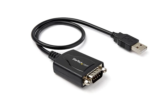

Then I connected it to a PC com port (USART1 via CN2). To do that I used a USB to COM convertor from StarTech.

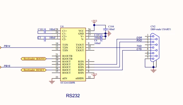

If your USB to COM convertor from StarTech is RS-232, you cannot connect that directly to USART pins...

CN2 is a DB9 RS232 port on EVAL board, top center-left

A also measured my USB to COM and got +/-9 V.

something like this :
ed: this is wrong. The CN2 is real RS232 connector, so i was wrong.
IF yes - you killed the cpu's.
Because this is real RS232 with RS232 level output (+/- 8 V or so) , but cpu is 3v3 system and needs a RS232 signal - but at 3v3 voltage level !

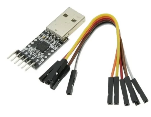

So replace the damaged cpu's , or buy new board. Then use for USB - Serial converter something like this :
USB -> serial (3.3 V level)
https://de.aliexpress.com/item/32696427768.html
No. The H7 Eval boards have a normal DB9 RS232 connector.
AScha.3
April 23, 2024
@Pavel A.  , your right. I just was thinking, he connect to a cpu uart ...
but CN2 is :
But then : what he did wrong ?

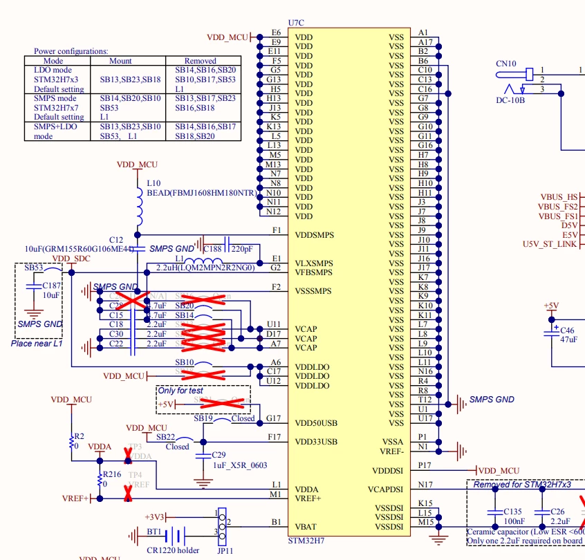

AScha.3
April 30, 2024
Did you set the correct power mode , according to the settings on your board ?
(smps mode, i suppose)
see circuit:

I see in my project (in ioc-file): RCC.SupplySource=PWR_LDO_SUPPLY, whereas it should be PWR_DIRECT_SMPS_SUPPLY. If I create a new project for the same board, the value PWR_DIRECT_SMPS_SUPPLY is by default. But in the working project I have no chance to select it, as it's absent in the menu. How to fix?
AScha.3
May 17, 2024
The DIRECT_SMPS should be there, maybe try : set chip revision V , set voltage scale 1 . (Just try...never seen this problem.)
Is this "working project"  so big ? If not, start new project (from correct board definition) and then just copy your user code parts from "working project" to the new main.c .
