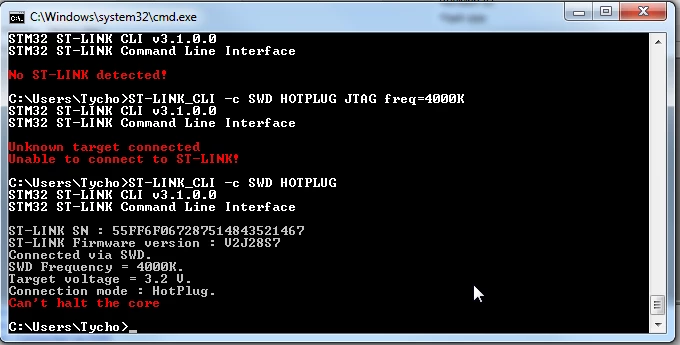

  • Tried the ST-Link_CLI

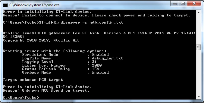

After this, I also tried to run the ST-Link_gdbserver to see if I could get a different response, but all I got was the following:
'Target unknown MCU target
Error in initializing ST-Link device
Reason: Unknown MCU found on target'
On the other hand, when trying the ST-Link utility, when running from 'Normal' or 'Connect Under Reset' mode, the utility pops a message saying stating:
'14:53:37 : Can not connect to target!
Please select 'Connect Under Reset' mode from Target->Settings menu and try again.
If you're trying to connect to a low-frequency application, please select a lower SWD Frequency mode from Target->Settings menu.
14:53:41 : Can't halt the core'

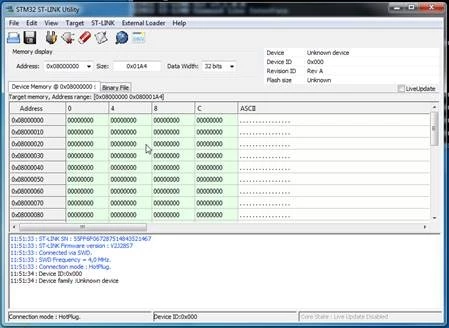

But, when running on Hot Plug mode, a connection is made available. What's interesting is that the Device ID is not recognized, nor is the Device Family.

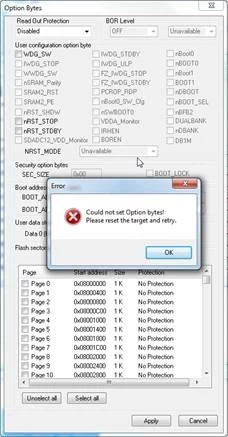

Although the FLASH memory cannot be erased due to a Read Out Protection, this read out protection cannot be disabled with 'Option Bytes', an error message pops up stating
'Could not set Option Bytes!,
Please reset the target and retry'

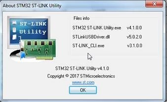

I'm running on Windows, Atollic 8.0.0, STM32 ST-LINK Utility v4.1.0.0, STLINKUSBDriver.dll v5.0.2.0, ST-LINK_CLI v3.1.0.0

HotPlug mode  connects target with no reset and not halts the target.  In your case Its not realy connects as you mention in your post(no ID no family, etc)
