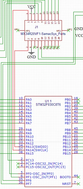

I currently working on a projet where I've ordered custom PCB with STM32F030C8T6 already installed by JLCPCB but I can't communicate with them.
I've connected the STM32 with 3.3V and ground and then I output the SWD and SWCLK pins. I connect the GND, SWD and SWCLK to the daughter board of STLINK to port CN6 on CLK, GND et DIO.
But when I connect the ST LINK to my computer the LED go red and I have a Fails.txt with "The interface firmware FAILED to reset/halt the target MCU"
Does someone know what I've done wrong or where can I found a solution. I've already searched on internet and I tried to put the Nrst pin to nrst of st link without succes and also boot to vcc or gnd but also wihtout success.

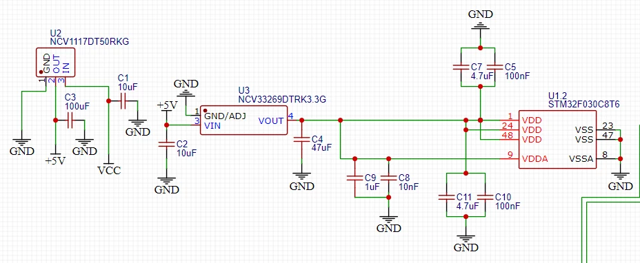

Start with a review of the schematic, and the orientation of the part.

Also, I've checked the schematics, the power is well connected as you can see here :
0693W00000GZMjgQAH.pngThe SWD and SWCLK are connected to an external connector :
0693W00000GZMk0QAH.pngThen I have the power from a power supply with 3.3V.

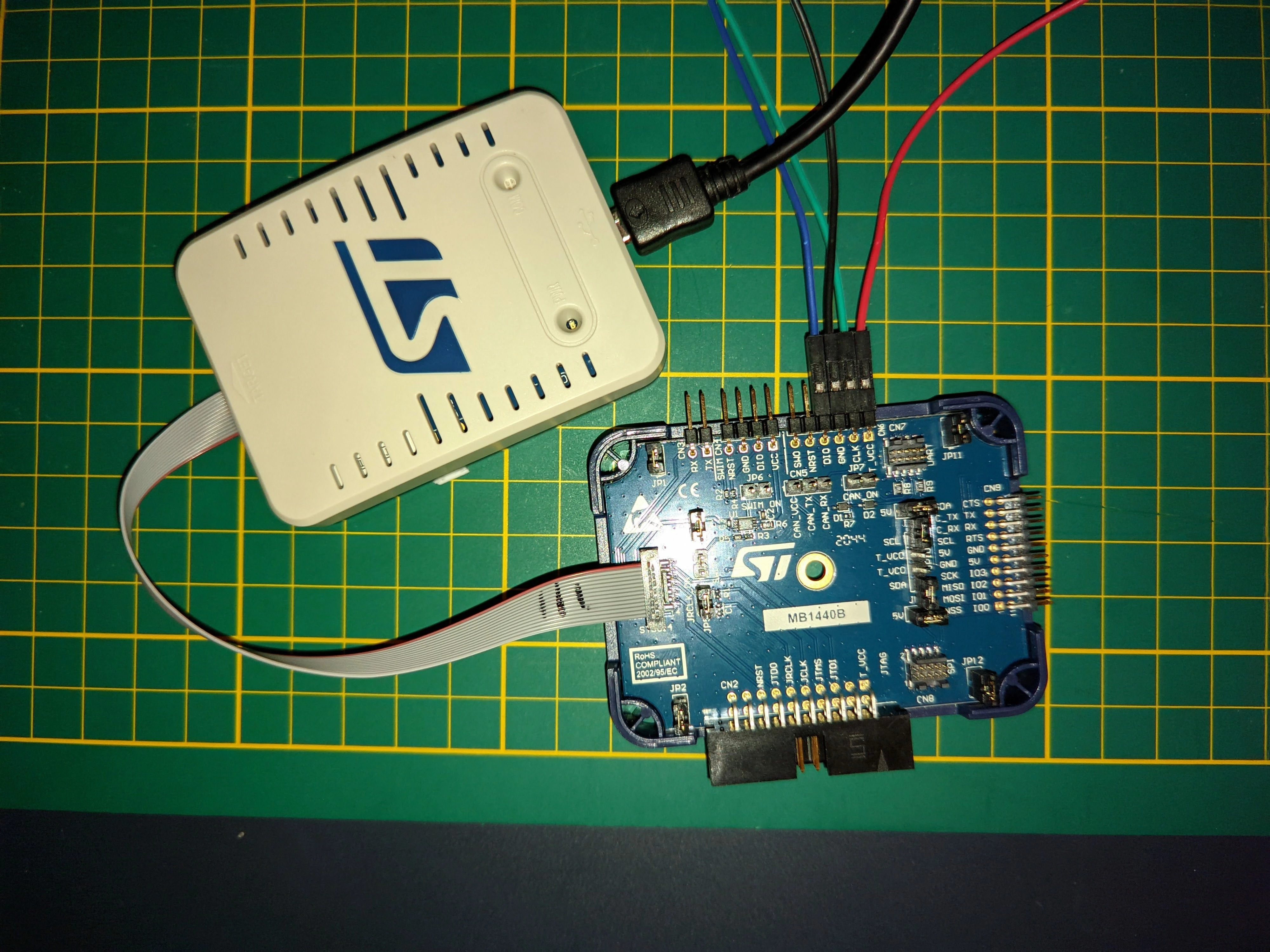

I've connected this way to the ST Link :
0693W00000GZMn4QAH.jpgRed : 3.3V
Green : SWCLK
Black : Ground
Blue : SWD

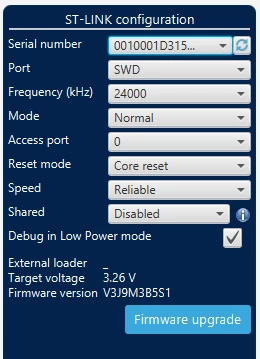

As for the software I'm using STM32CubeProgrammer
Here is the config and you can see the 3.3V is read :
0693W00000GZMogQAH.pngAnd when I press connect I've got this message : 0693W00000GZMpAQAX.pngWhat can I try ?

>>What can I try ?
Try a lower connection rate, 24 MHz is typically too high for CM0(+) devices, start with 2 MHz
Typically SWCLK,SWDIO and NRST are suggested.
A device that is not electrically functional will not respond.
Check NRST is normally HIGH, pulled-up internally
Check power on VDD/VDDA
Check part orientation
Check pin assignments and netlist
BOOT0 is typically pulled LOW externally so the part runs User Code properly out of reset.

Try to disconnect external oscin and osc out, check the package pin 1 is correct, maybe top or bottom view confusion... happens for connectors too. Sanity check.

24 Mhz rate with wire jumpers is challanging.
