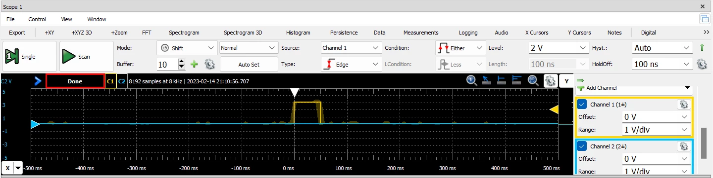

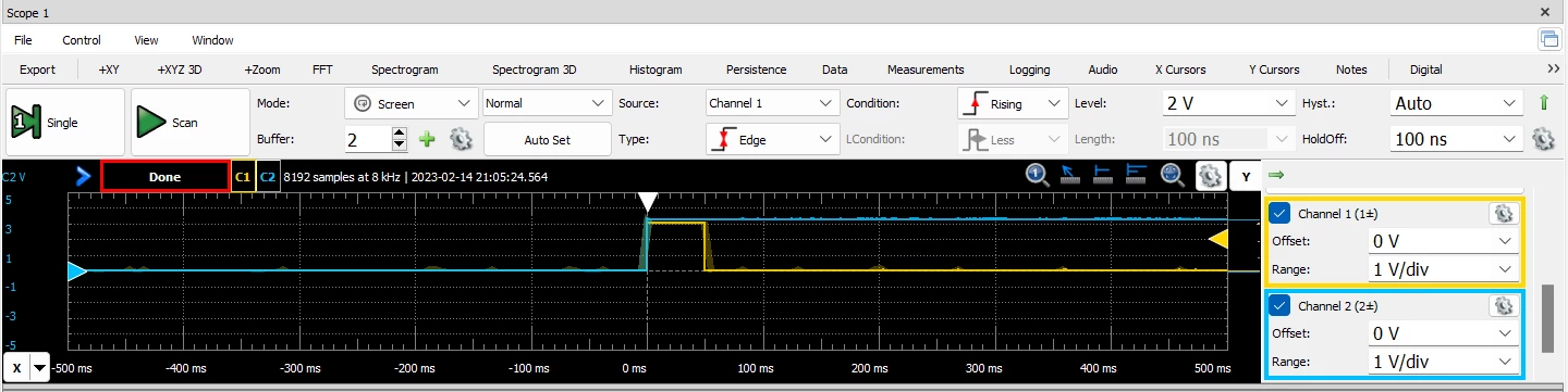

Scope Captures of Normal Operation (Input - yellow; Output - blue)

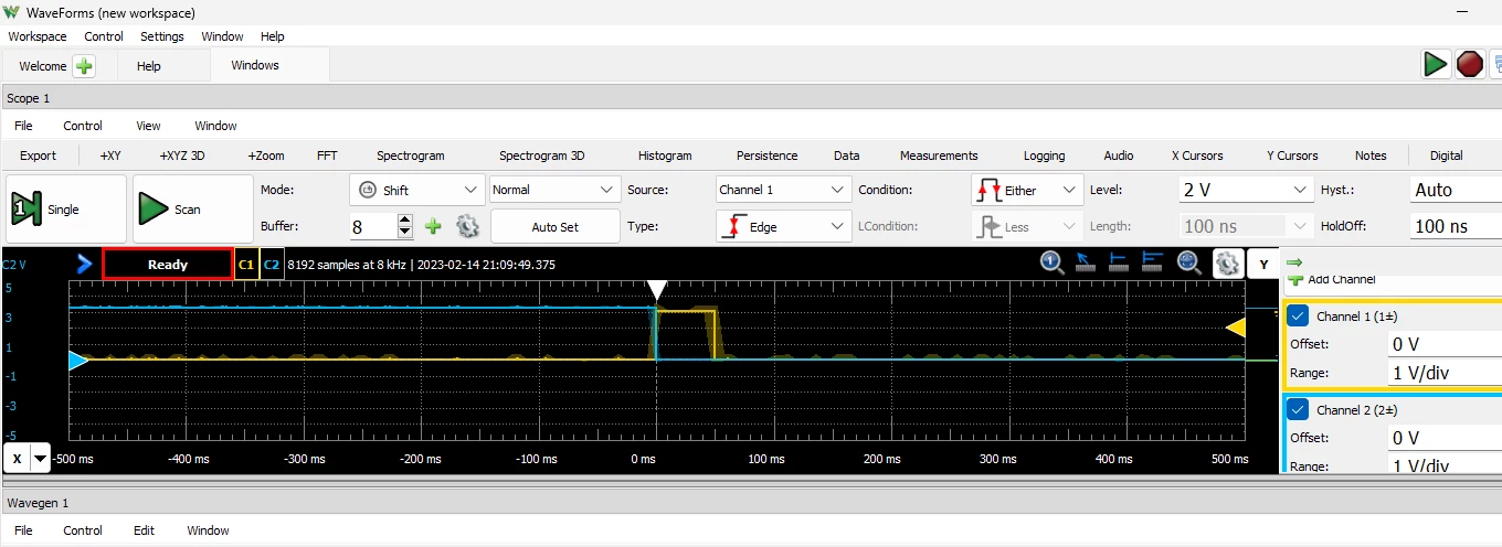

Scope Capture of the Insidious Bug

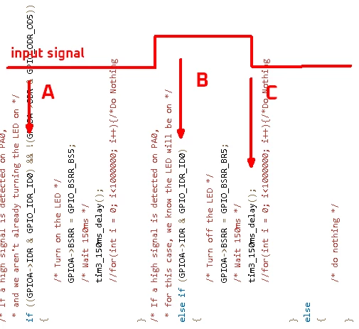

This happens if the input pulse's rising edge happens during execution of code between the first and second if():
A: (GPIOA->IDR & GPIO_IDR_ID0) is false, thus the whole first if() is false, proceeding to else-leg i.e. second if()
B: if ((GPIOA->IDR & GPIO_IDR_ID0) is true, so output is cleared (it's already zero so you see no change) and the 150ms delay follows
C: the input pulse is <150ms delay, so at the point where 150ms delay ends, the input pulse is already 0 again
You should detect the edge of input signal (i.e. "if previous level == 0 and current level == 1, toggle output level and do the debouncing (delay); remember previous level; loop). Loopdelays are good only for testing programs, you should learn how to get rid of them.
