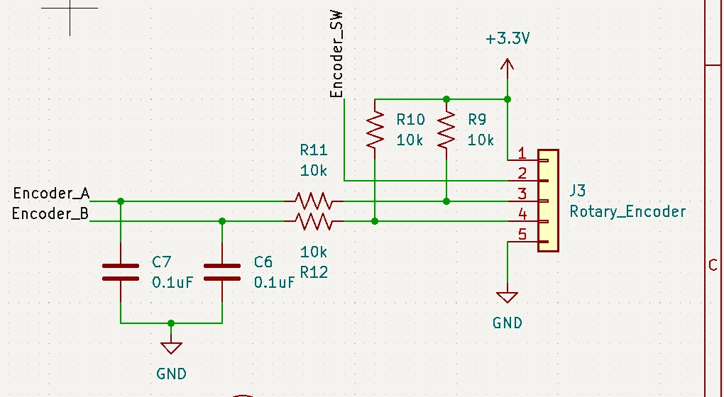

I have a project with a rotary encoder and I'm trying to use one of the timers in encoder mode to keep it's position but I can't seem to get it working and I don't know what I doing wrong. Any help would be much appreciated, if any more information is needed I will do my best to provide it.

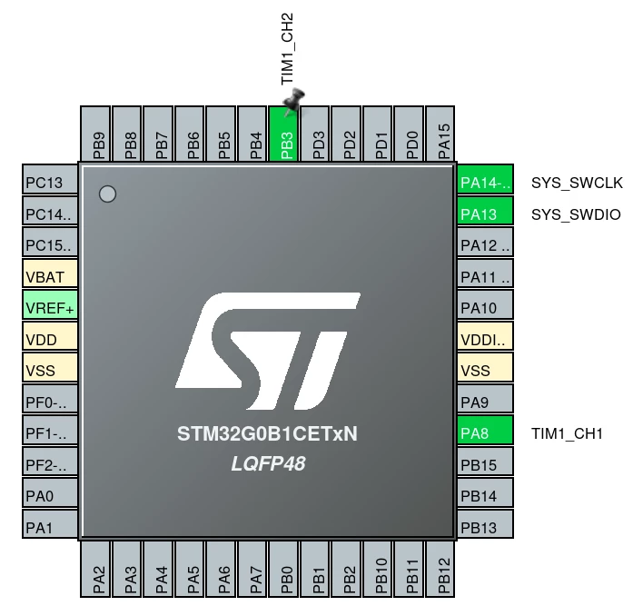

The chip I am working with is an STM32G0B1CET6N. I am trying to use TIM1 to interface with the encoder. I have attached a screenshot of the code configurator of the pin assignments.
The encoder I am using is from CUI part number ACZ11BR1E-15FD1-20C. I connected it using the recommended filter which is a 10k pull up and an RC filter with a 10k resistor and 0.01uF capacitor on both A & B encoder lines. I did notice while going back to gather information for this post that I actually got my parts wrong on my board and used 0.1uF capacitors instead. While this does probably explain rounded corners of the square wave I was seeing on the scope, I don't really think it is the cause of my issue. I didn't think to get a screen capture of the A and B line waveforms but can get one if necessary of course. I have attached a screenshot of this portion of my board. I mounted the encoder's shaft directly to the PCB so that's why they're going to a header, I just hand wired the pins to those holes.

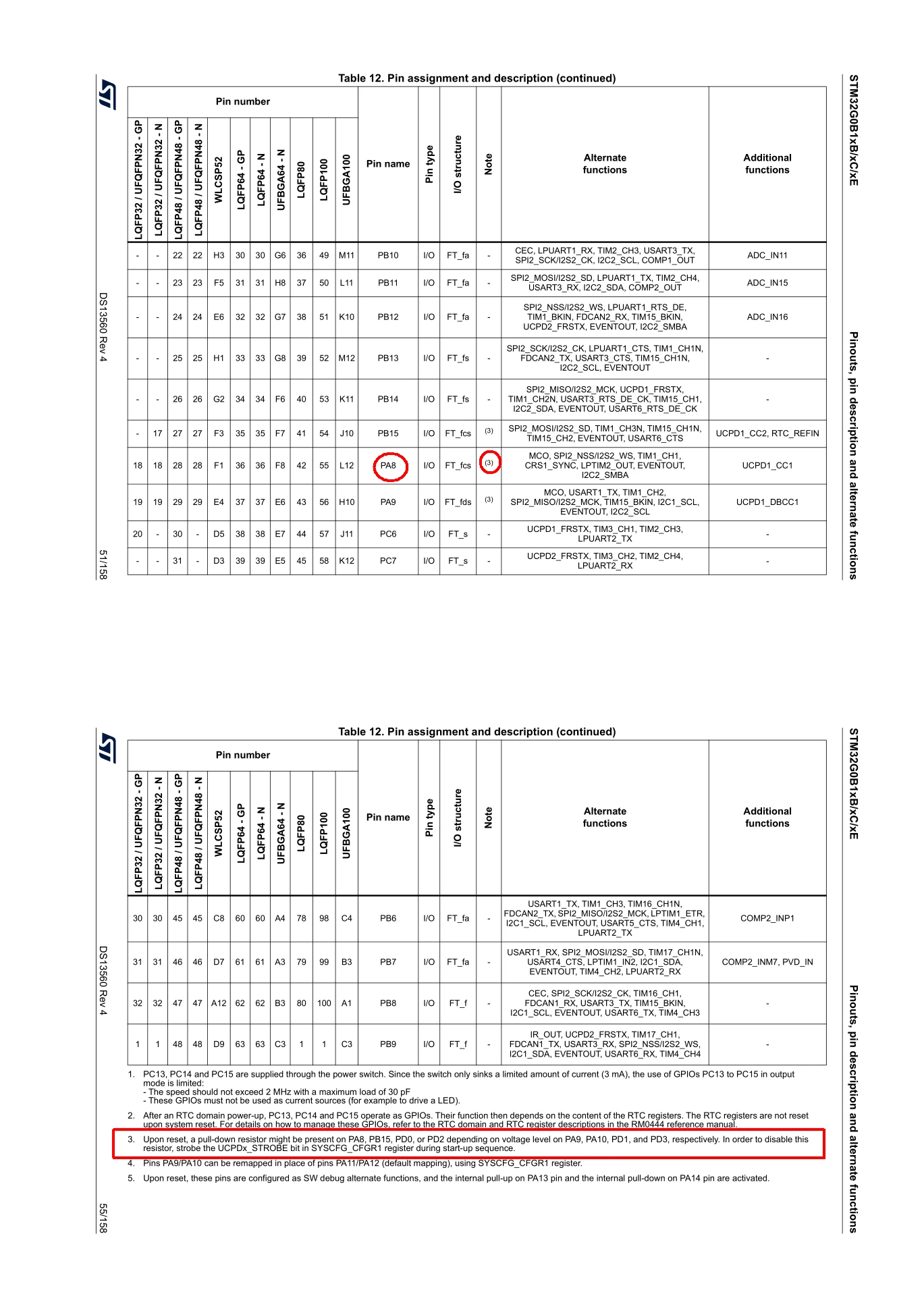

I have been up and down the code and can't seem to find anything that could be causing this or that I'm doing wrong. I used an oscilliscope to check the output wave forms for the A and B lines and they both looked as expected for a quadrature encoder. The only thing I found was that the A line was lower than the B line, measured on the encoder pins to ground. Channel B was 3.3v as expected but channel A was just 2v. After removing parts systematically to find the issue I found that none of the resistors or capacitors were faulty but that the fault appears to be within the micro. After completely lifting that pin (PA8) from the circuit, I could measure a resistence of 5k ohms from that pin to ground when the micro was running. This makes sense with the voltage measurements I was getting; ~.6v at the micro pin and ~2v at the encoder.
So it seems my micro is pulling the pin down with a 5k resistor or something and I can't figure out why. As far as I can tell the pull ups and downs are 40k anyway so it can't just be that. It is only affecting the one pin, not the other timer pin. I don't even know if this is what my issue actually is or if I'm just chasing my tail but it's the only thing standing out that I don't understand.

This is the infamous USB-C PD Dead-battery gotcha.
After you disabled the pulldown, if the encoder still does not work, read out and post the TIM and relevant GPIO registers' content.

This was it, thank you! That's what I get for not reading the note, lesson learned!
