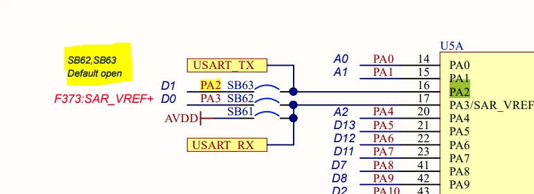

Hello everybody,
I am trying to get PWM Mode 1 working with Timer 15 Channel 1, but PA2 (D1 Pin on the Nucleo L476RG Board) doesn't output any signal. The inverted Channel (CH1N) on the other hand is working.
I also tried to configure PA2 as an output and setting it to High, but couldn't get a signal.
First i thought it's maybe a problem, as PA2 is the pin for Tx UART, but i deactived the UART in the CubeMX software.
I am using STM32CubeIDE Version: 1.11.0 Build: 13638_20221122_1308 (UTC)
Thanks for helping me out already.
Kind regards
blauer_enzian

TDKBest answer
July 27, 2023
Did you look at the Nucleo schematic or user guide to see if the pin is hooked up or hooked up to something else?
Edit:
Solder bridges are default open. This is likely the issue. It's usually in the user manual as well.
2 replies
TDKBest answer
July 27, 2023
Edit:
July 27, 2023
Thanks for your quick reply!
That is the issue yep. I just hooked up the probe directly before the solder bridge (SB63) now everything looks like it should.
