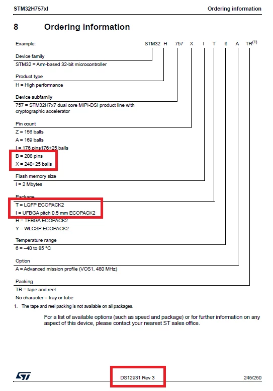

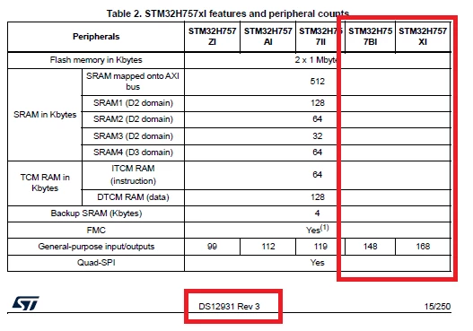

You can use it but as you said the difference is in io numbers so you need to select the common pins to port your firmware directly to the final mcu target.
For more information refer to the datasheet / table 2 and section 8.

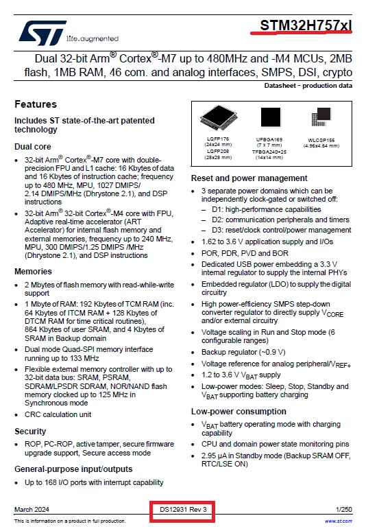

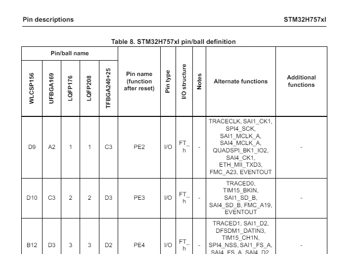

problably I not open the same datasheet, because I not found table 2 and section 8.  The datasheet that I did see is stm32h757ai.pdf  and this datasheet the section is 5 Pin descriptions and table is table 8. STM32H757xI pin/ball definition
Thank for your answer!Table 8. STM32H757xI pin/ball definitionTable 8. STM32H757xI pin/ball definition

No. It's the correct datasheet that I'm referring to. Table 8 doesn't show the feature differences between the part numbers but only the pinouts. In your situatio you need to look at the internal memory sizes, the peripheral instances etc not only the pinout.
These are the screenshots from DS12931 Rev 3:
Table 2 showing the difference between the part numbers:
Section 8 showing other details:
