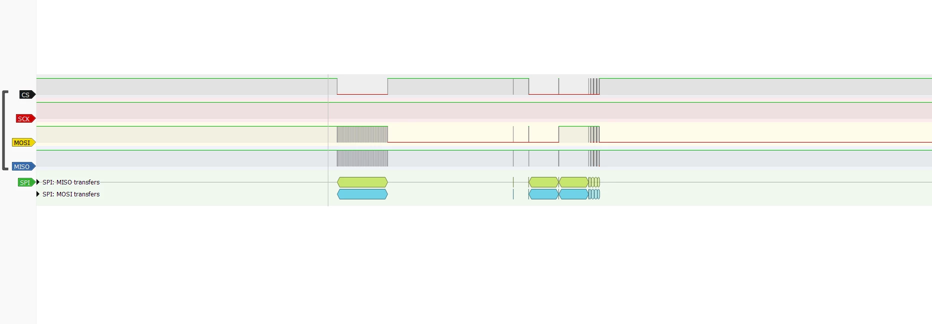

I am trying to get the above named board to work with an ILI9341 based display. But it is not working. I took a look at the SPI lines with a logic analyser. I saw that there was no activity on the CLOCK line. I switched to an alternative pin for the CLOCK signal but I did not get any result.

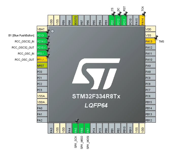

Have you checked the board's User Manual and/or schematics to see if there is anything else using that pin?
Can you toggle that pin just as a basic GPIO?
Is there any activity on any other line(s) ?

1. I checked illustration in the STM32CubeIDE (see the picture below). There's a green LED called LD2 using that CLOCK LINE.
2. I can toggle the PIN as a basic GPIO.
3. There was activity on the MOSI, MISO and CS line.
4. This is as close to a schematic as I can get (see the picture below). I attached the updated code to this post. Let me know if you need any other info.
The display is being powered by +3.3V and GND.
Screenshot of the SPI signals.
